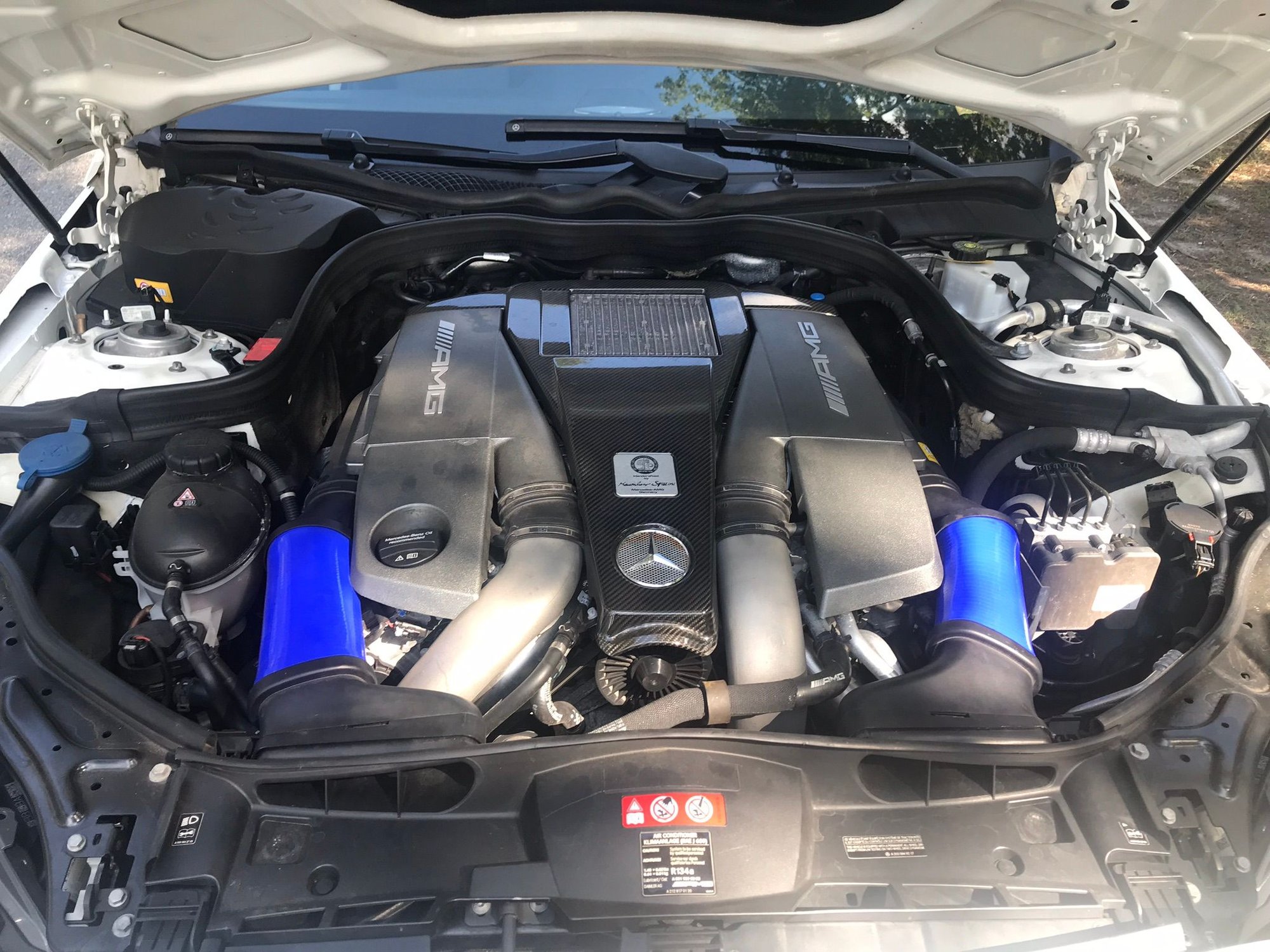

I did the same when I installed my intake, haven’t had any issues so far.

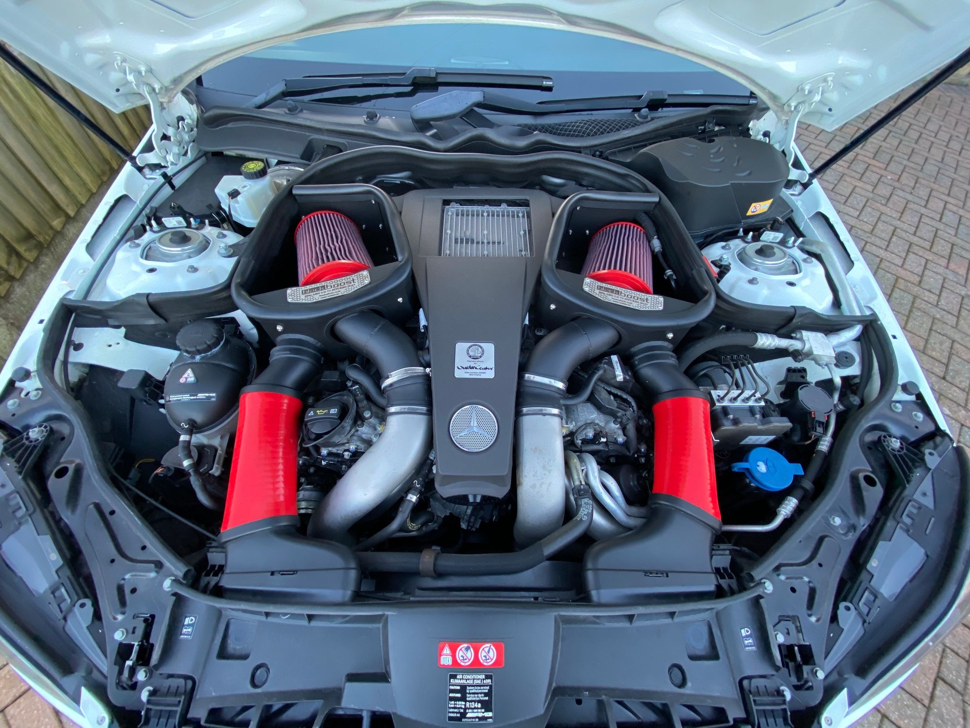

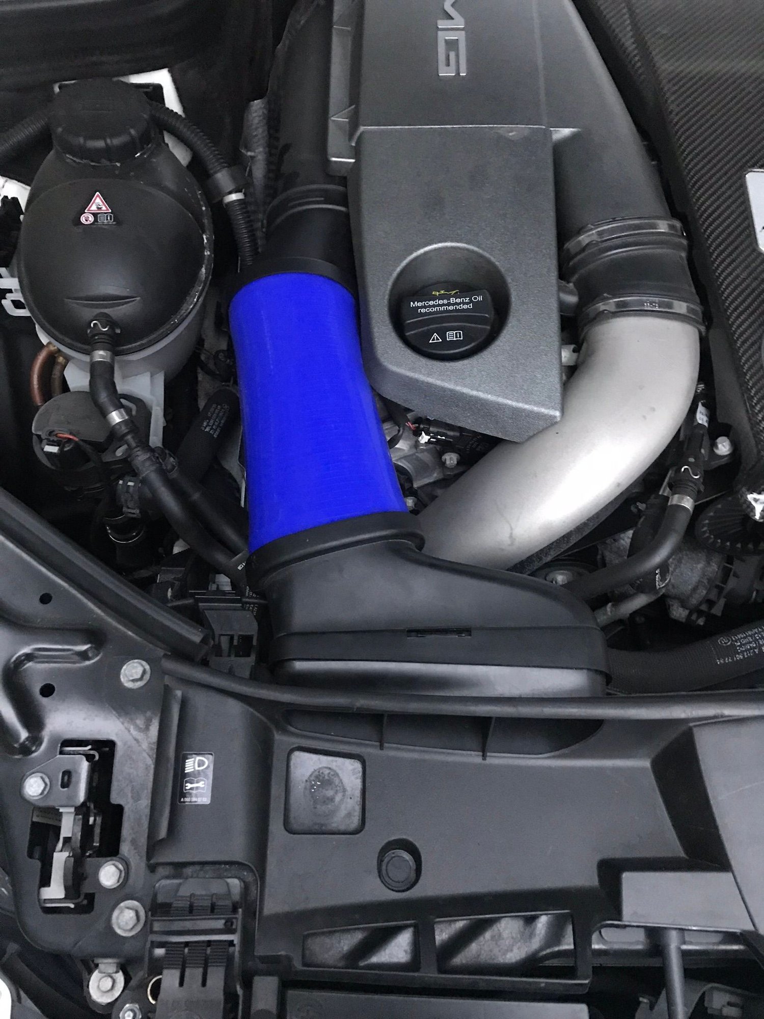

I just bought some decent 76mm hose on eBay and cut it to size it isn’t a secret or anything haha… my old intakes were splitting so I removed the cloth centre part and kept the two ends then cut the hose to the right size and length and then stretched it over the two end pieces. It isn’t under any great pressure so as long as the length is right they will stay in position, I know some people have mentioned them collapsing but I haven’t experienced that at stage 2 on my car and have been running it for a while now.

yeah they are straight pieces and the end at the bottom has to be cut off at an angle and squeezed into an oval shape to fit.
