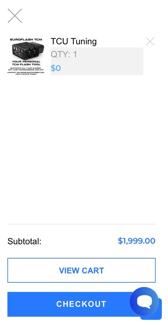

Glad you brought up this topic again, as I was just re-reading a couple of old threads about the EC TCU tune and really contemplating on getting it. I wonder if the price is still $1800?
Eurocharged has it listed for $2k, bummer would hope it would be a little cheaper after the early adopters!
Where did you see that? I couldn't find anything about TCU tuning on their website.
Old Jan 5, 2021 | 06:11 PM
NoVAe63s's Avatar
Joined: Oct 2019
Posts: 415
Likes: 165
From: Northern VA
2016 E63s
You have to select the ecu tune, then it shows up as an "add on".

2016 E63s
Originally Posted by diamondblak05
But if you click on the TCU tune itself, it says it's $1699?
I didn't look anywhere else so you are probably right. When I click the "add" link it still gives $1999. But for $1600 I'm in!
