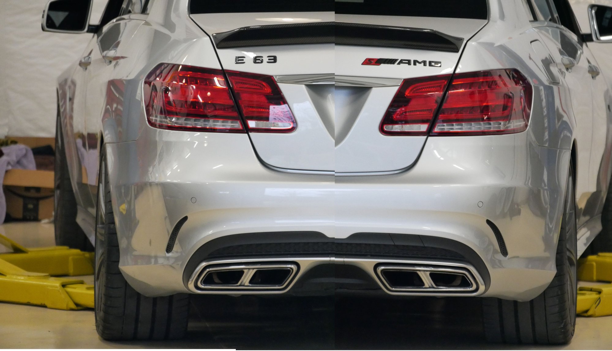

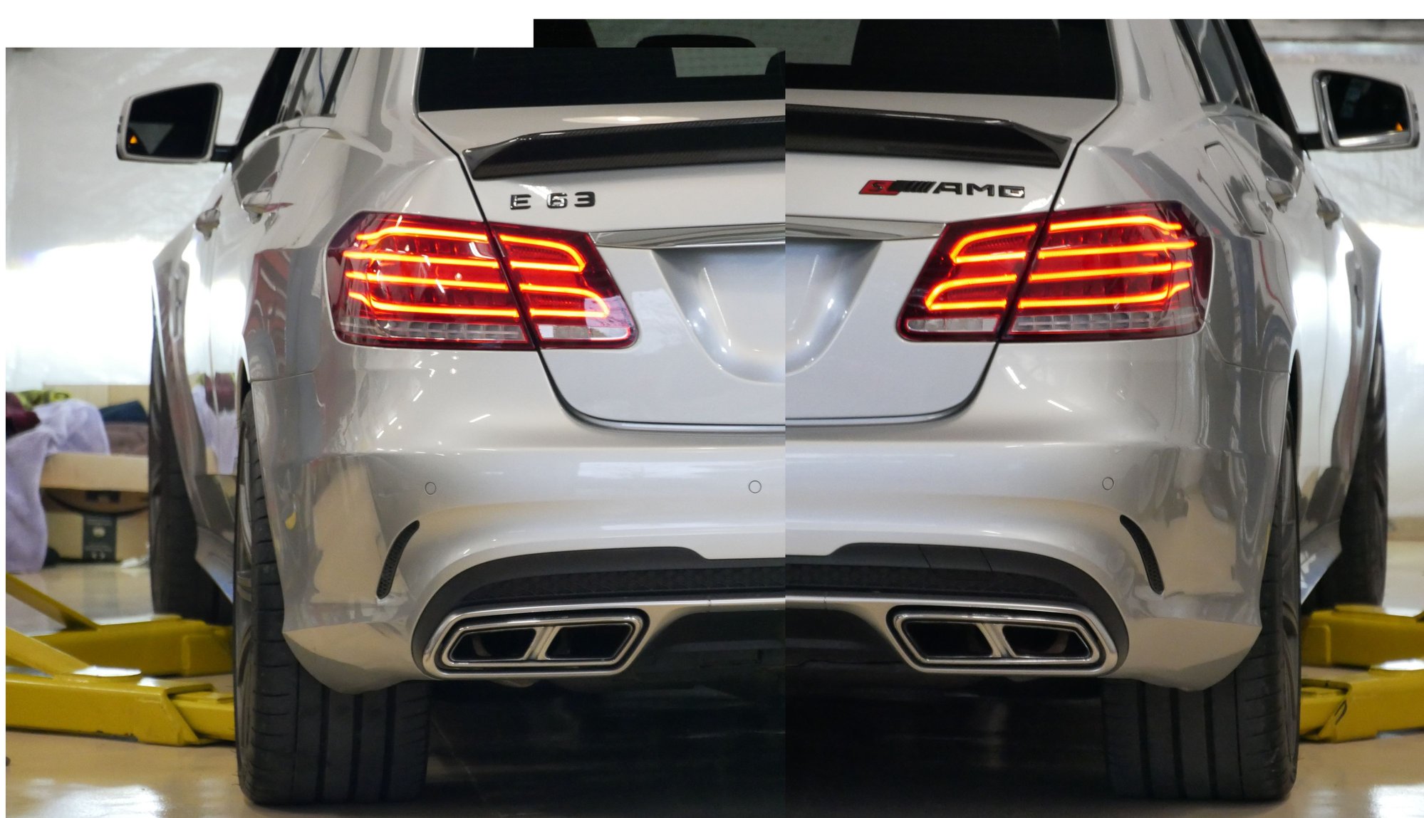

Hard to catch it since it's flush with the fenders. Here's a before and after. Might be able to see it slightly if you look by the exhaust tips. The first and 2nd Picture are before/after. There is no rubbing going uphill or downhill, as well as normal driving in sport mode

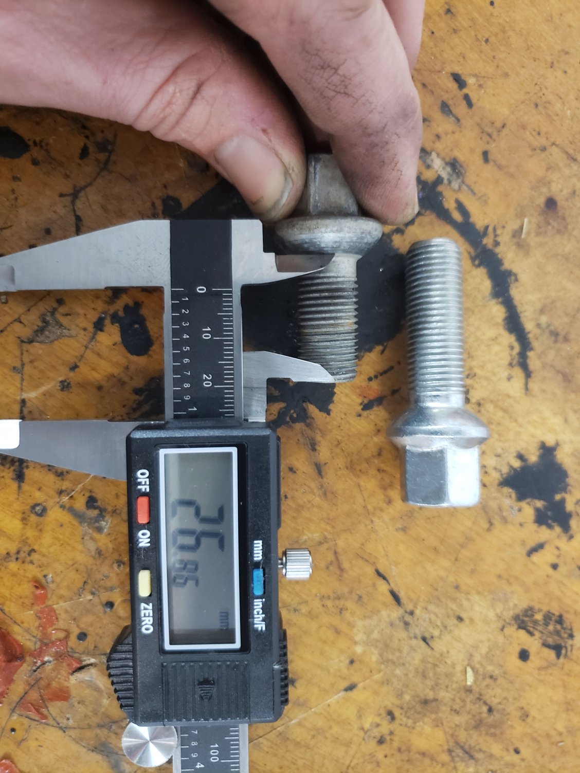

She will help you out and get you sorted. Just a FYI they have 2 diffrent size bolts. 2 1/4" and 1.75". The 2 1/4 were to long and touched the rear brake dust shield causing noise. Make sure you measure the ones you receive and make sure they are not the longer ones. I got mine replaced for free, but did have to wait 2wks until they showed up due to holidays.

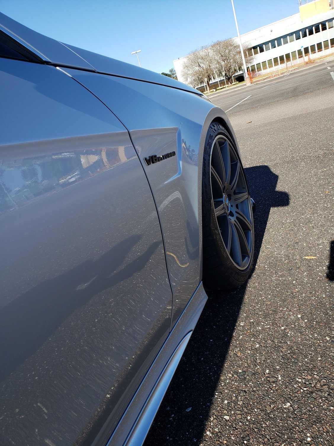

installed a 10mm on the drivers side rear, No spacer on the passenger for testing. first picture is in C mode with 26.5 ground the arch height and the 2nd is in sport mode with 25 5/58" arch height. H&R springs up front with 25.25" height.
I think its ideal IMO
And when drive line is under load, it will squat and will sink inwards

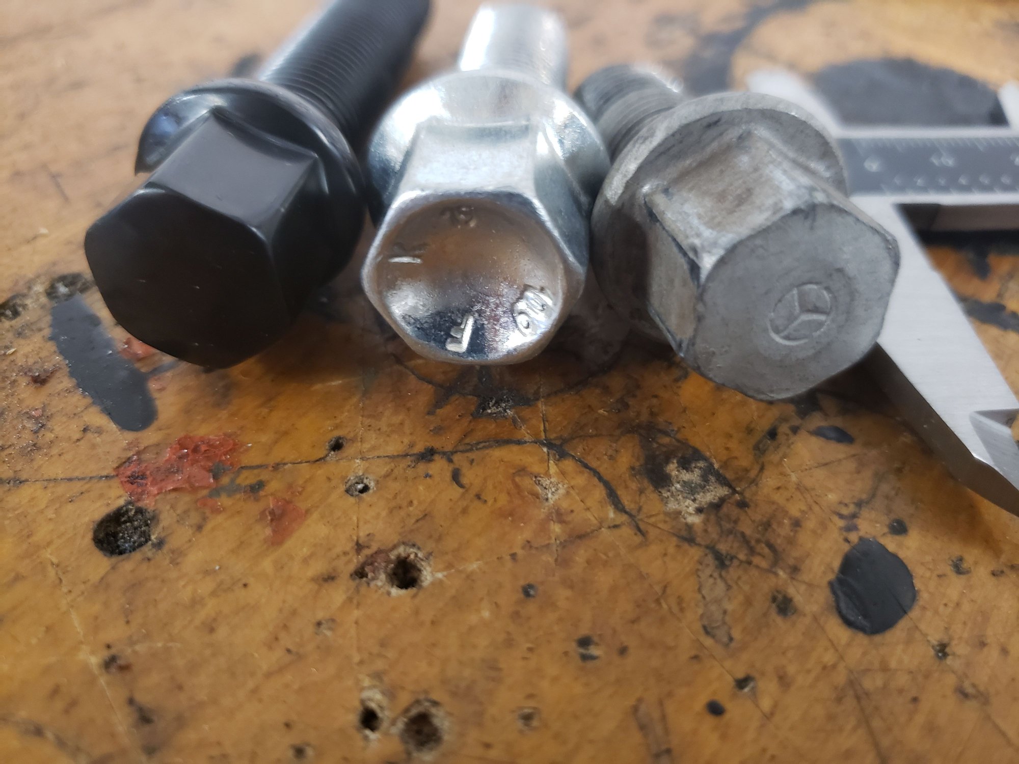

I ordered my spacers from amazon $67, came with super long 55mm black bolts, almost guaranteed to be Chinese junk. NOTE: if you install long bolts in the rear, you will destroy your parking brake.
I don't trust those bolts anyway, so I bought some H&R 40mm bolts, PN 1454002 for $55 more, Should be here today
I may return the spacers and buy a kit with no bolts, looks like there are about$40-80

Originally Posted by C2 Turbo
Thought i read somewhere, spacers smaller than 12 don't need longer bolts, am I wrong?
You absolutely need longer bolts for any size spacer. Even with the 10 mm spacers, the stock bolts won't even turn one thread.
Always figure out what the stock length is, and get a bolt that is exactly longer than the thickness of the spacer.
Also taking to consideration the power were put into the ground.
​​​​​ I'll look through all the kits, they all come with the same bolts it looks like. Some claim their 10.9 others claim their 8.8, but none of them are marked.
I just got the h&r bolts today, they have 10.9 stamped on them.

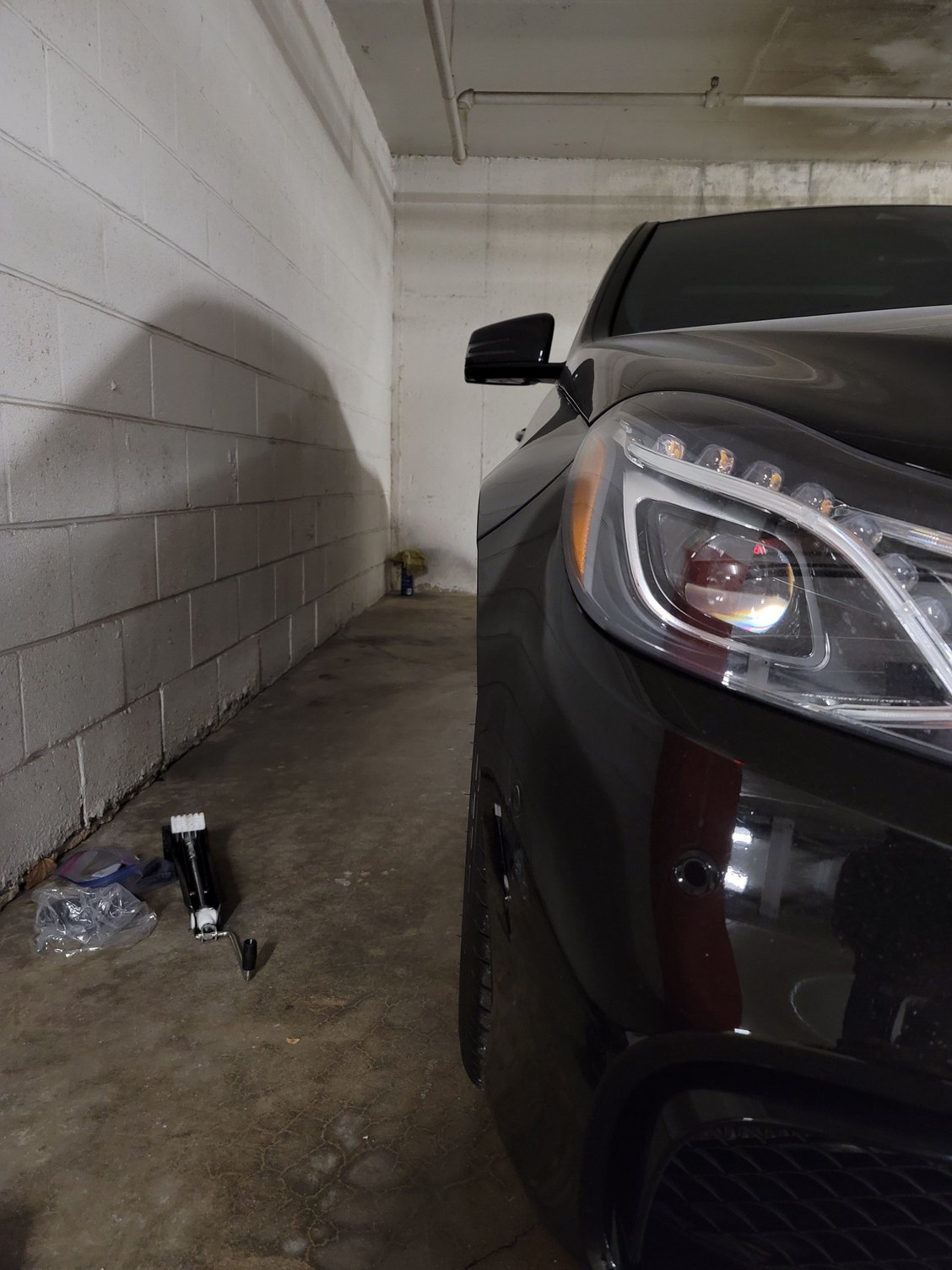

Got the 12mm front spacers Installed. Keep In mind this is right after car was lowered, suspension hasn't compressed fully. 12mm spacers with 40mm bolts. Left side before, right side after. All my bolts are grade 10.9
