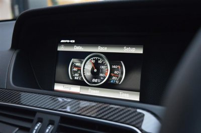

That's interesting so you guys don't have this screen showing the tranny temperature on a W212 E 63 AMG?
https://cimg0.ibsrv.net/gimg/www.mbw...f22286d9bf.png
https://i.ytimg.com/vi/lLQVHX0VHx0/sddefault.jpg
What about this screen? https://forums.mbclub.co.uk/data/att...ash=xaQr5zn4B-

Interesting, maybe that's a Canadian thing for that line of vehicles?

BDC90's Avatar
Joined: May 2023
Posts: 463
Likes: 169
From: Endless Mtns. PA
2014 E63 AMG wagon 1965 Austin-Healey 3000 1970 AMC AMX
mine is Canadian and I don't have that. 2014 wagon.
Old Jan 31, 2025 | 11:48 AM
BDC90's Avatar
Joined: May 2023
Posts: 463
Likes: 169
Maybe a RHD thing?
Old Jan 31, 2025 | 12:02 PM
PeterUbers's Avatar
Joined: Jun 2004
Posts: 13,799
Likes: 3,232
Originally Posted by BDC90
Maybe a RHD thing?
says he has a 2014 wagon ... in Ohio
Old Jan 31, 2025 | 12:04 PM
deese's Avatar
Joined: Jan 2025
Posts: 7
From: Ohio
2014 AMG E63s wagon
haha, sorry - before everybody runs out to try to find that screen, meant the coolant and oil temp monitors, using coolant temp as a general correlation to transmission temp (maybe there isn't one? is that not a good go-by?). Regarding the jerkiness though, it seems like it can happen anytime when accelerating from a stop within the first 10minutes of driving.
Old Jan 31, 2025 | 12:08 PM
BDC90's Avatar
Joined: May 2023
Posts: 463
Likes: 169
Good clarification, Jerky normal when cold. Trans temp gonna be different than oil temp. You need icarsoft or something similar for trans temp. You may want to peruse thr oil solenoid thread. That reduces oil warm up.
