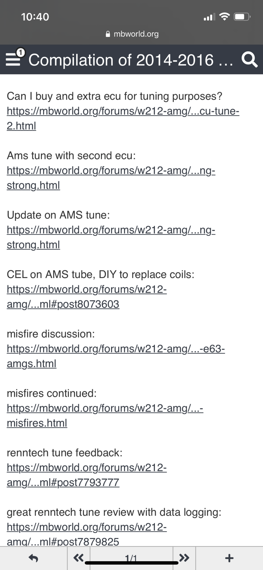

Common on m157
check out the sticky
https://mbworld.org/forums/w212-amg/...ml#post8073603

#5 coil is right next to the turbo so it takes a ton more heat from the turbo causing the coil to degrade and you’ll see misfire issues. Just replace it, or if needed swap #5 with #6 coil and it will go away which I’ve done while waiting for new coils.
read the sticky PeterUbers sent explains thiS
