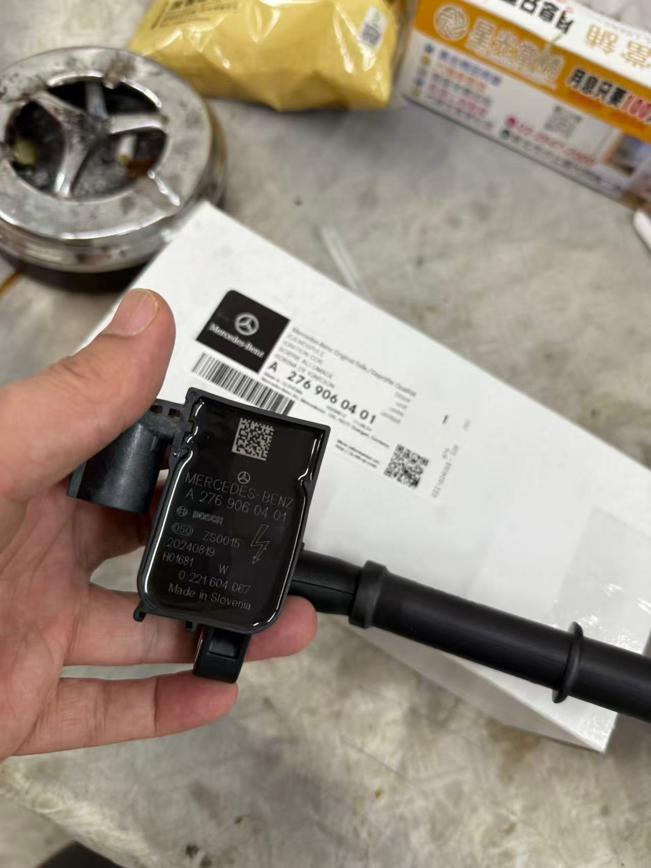

Based on what I just ordered yesterday, BERU no longer makes for it and now all Bosch for MB and both Bosch and MB OEM by Bosch all made in Slovenia.

further findings
Found Delphi by BorgWarner that made in Germany imported on TaoBao China. Will have to find out if those are real imported from Germany or faking aftermarket parts. To be tuned.
