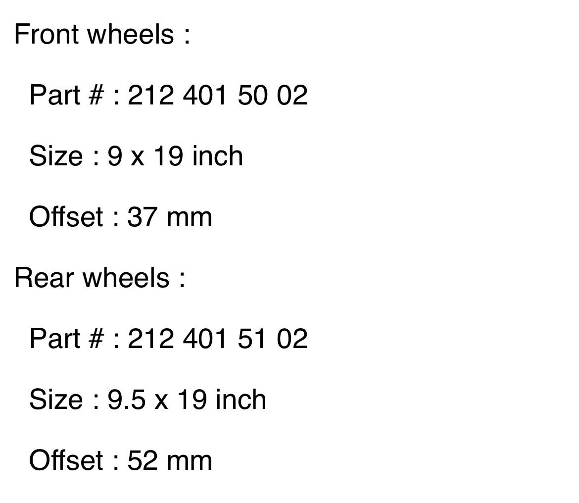

From: NYC
E63S
Would the CLS63 stock rear rims help at all?
These are the specs of the E63's wheels. But I get what you meant. I do recall the CLS63's wheel specs were slightly more aggressive.

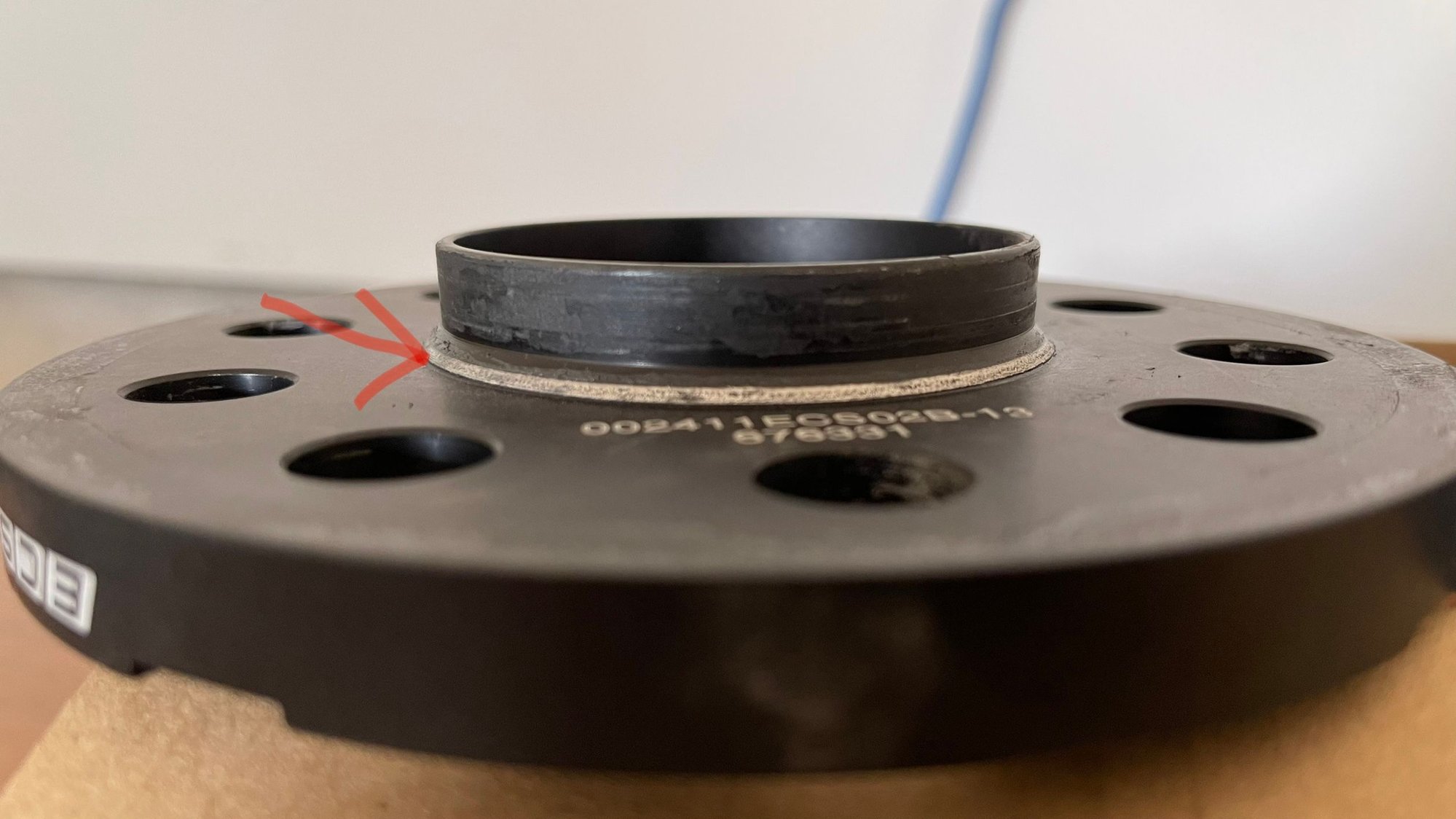

So here’s the problem with the 12.5mm ECS spacers and why mine started vibrating after a bit of time.
This chamfer is too large and the smaller wheel bore interferes with this larger diameter and can’t let the mounting face truly touch flat. It’s close, but no cigar. Notice how it’s galled and worn after a few weeks... no good. I was wrong in my posts up there where the spacer seemed to sit flush in the wheel. From the wear my spacer is showing apparently it doesn’t.
Im really interested now if the 15mm ECS or HR or ? will have this chamfer or not.
Do I clearance my wheels? I’ll look harder soon…
Here's the 15mm spacer from Supreme. Still have the vibrations at 90mph. It still has that same lip as the ecs spacer above
The fronts are the same on CLS, the rear's are 1/2" wider. This is from my notes I've collected lurking on mbworld:
CLS Front Wheels: 9Jx19 ET37 (p/n A2184011700) - 26.8lbs
CLS Rear Wheels: 10Jx19 ET47 (p/n A2184011800) - 28lbs
