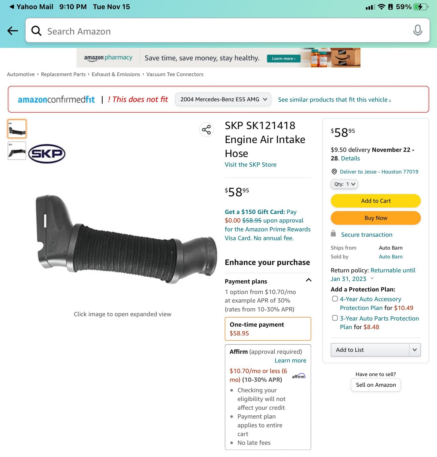

I used to have something similar to this on my car, but now I have black boost intakes with their silicone tubes. You might be able to find something like this on Amazon. they are much better quality than the factory version

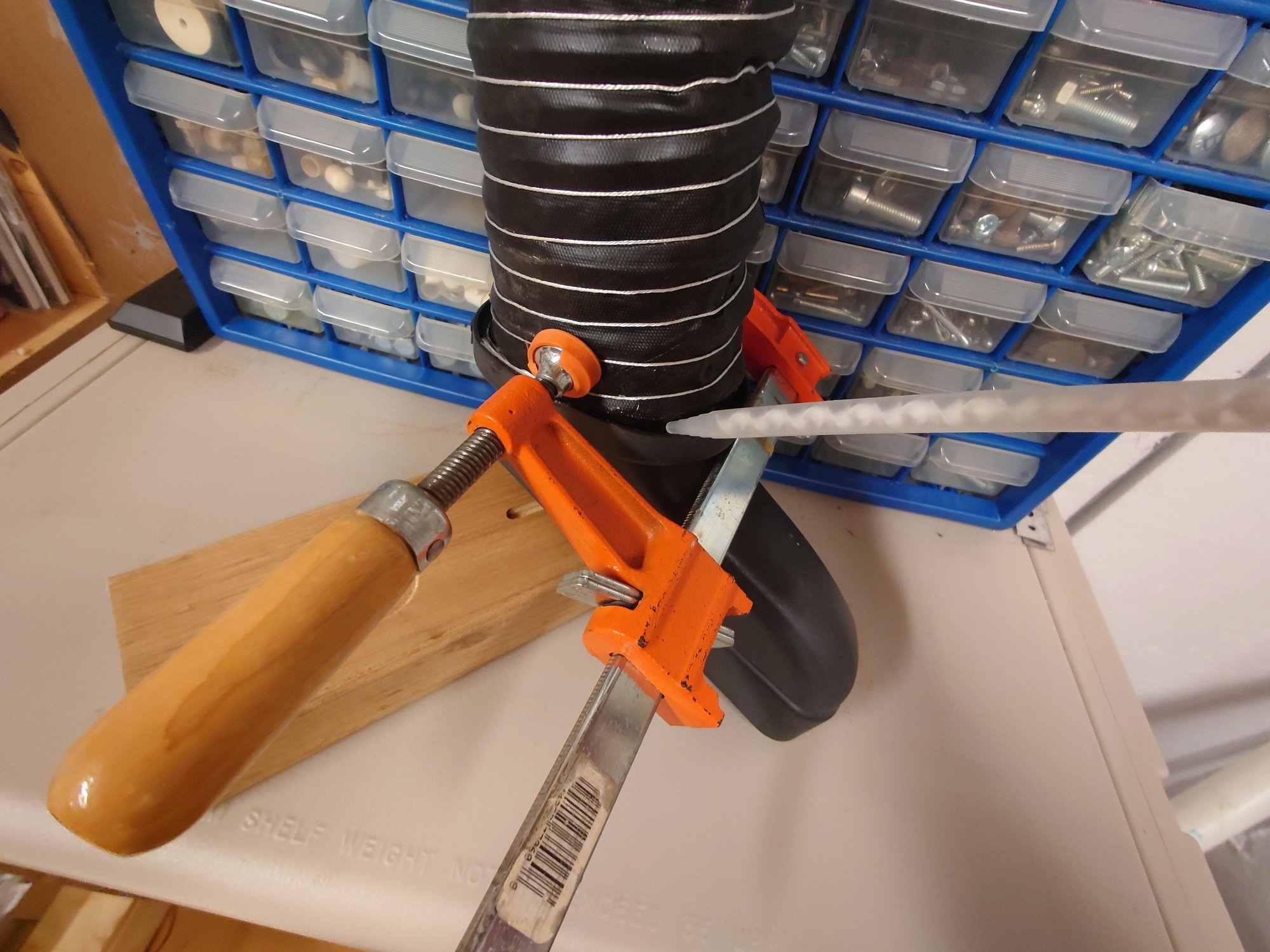

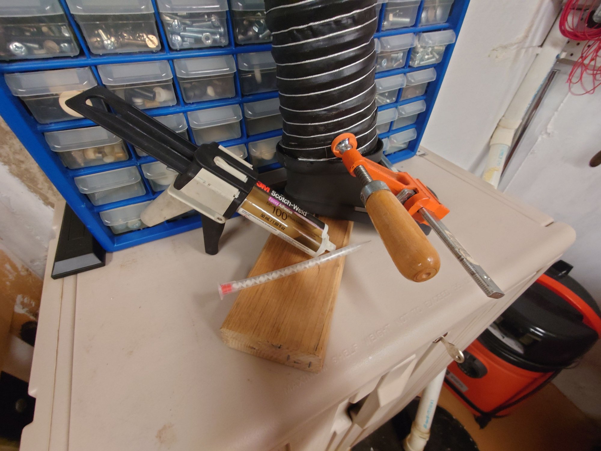

When I purchased my car, the originals were wrapped with electrical tape. Found inexpensive replacements with the same OEM look on Aliexpress. As an experiment I tried a meter long chunk of the wire reinforced hose for a set of back ups. (also Ailexpress) Used a clamp to squeeze the round hose into an oval shape while the glue dried.
