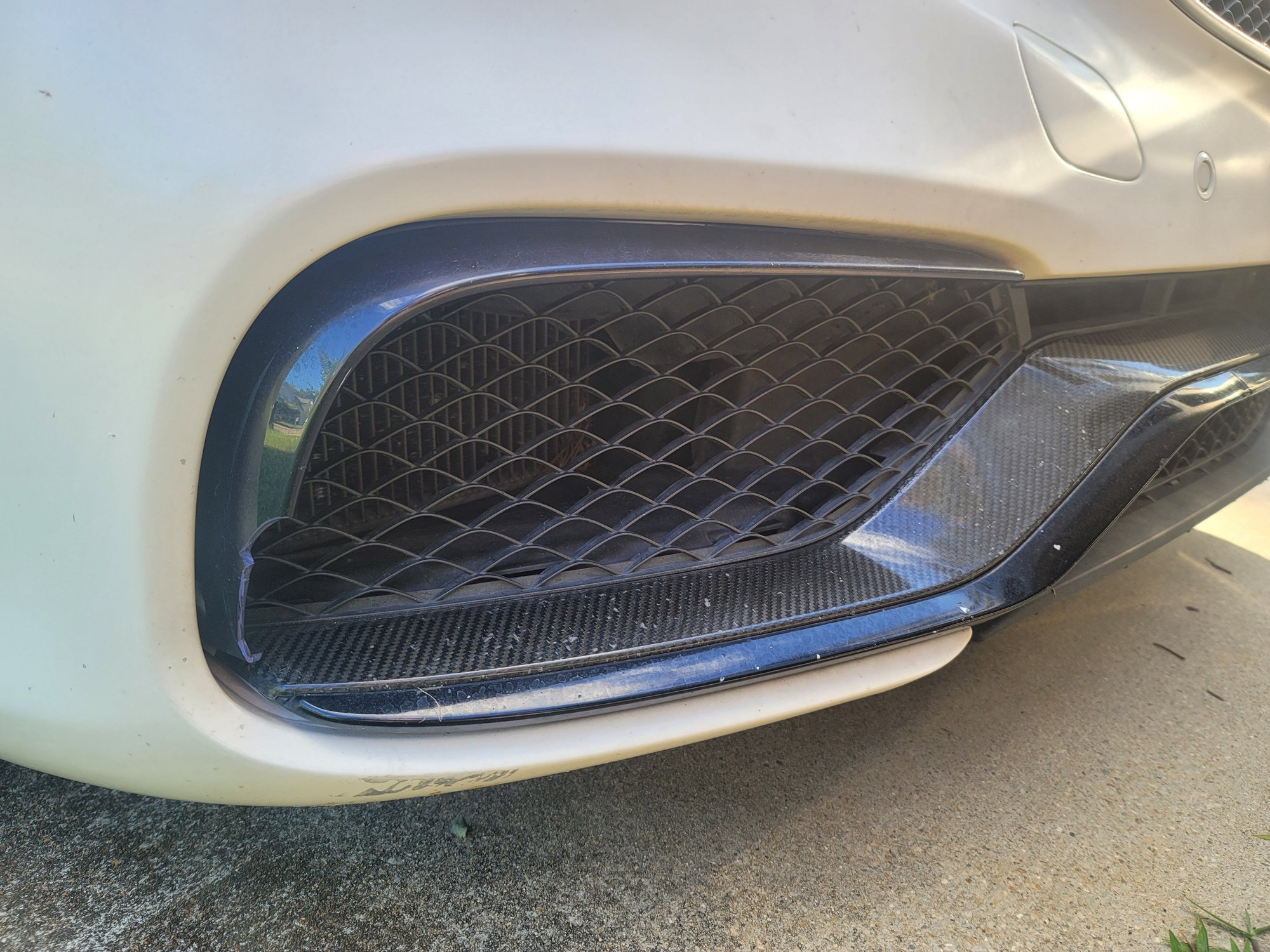

So does anyone know how to replace these trim pieces? I went out to try to do it and it looks like i should be able to yank them off but i didnt want to break anything so i stopped. Any help would be greatly appreciated.

Bumper has to come off
that piece is riveted from the back

Yup, bumper comes off. Cause there are screws that hold it from behind. It’s easy to replace. I replaced mine on the same side last year. Like 30 minutes of work. $800 charge from the dealer is straight up highway robbery considering that piece was like $50.

They're actually torx screws on the back side. The bumper has to come off, it's not that hard, probably takes about 10 minutes to remove the bumper. Just careful not to scratch anything.
does the bumper have to come off to remove the piece that is carbon fiber in the pic above? Thinking about painting or wrapping it.
most certainly
