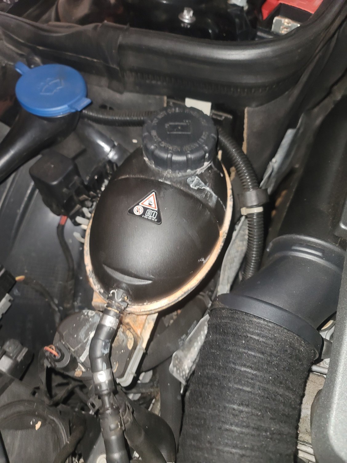

My 2014 E63 S is using what seems like a lot of coolant. I purchased pre mixed 50/50 from the dealer when I got the warning that is was low about a month ago.
After a long drive like 300 miles round trip - the car needs more. I see visible coolant on the reservoir - but it just doesn't add up to the amount it's using it seems like. Is it evaporating out through the leaky reservoir or possibly somewhere else. There's never coolant on the floor of the garage, so I know it isn't the radiator or hoses.
Any ideas besides the obvious, replace the reservoir?

I'd probably start with the reservoir by the looks of it.

The reservoir forms a hairline crack and because the system is pressurized it will spray out in a fine stream and it's hard to see with the naked eye unless up close.
Replacing the reservoir is step 1.

Ordered new reservoir and cap from FCP Euro. Should be here next week. Now I just need to find a solid DIY video. Many out there - just not seeing the proper bleed technique, which I assume I need to do as well correct? Should I flush the whole system or can I get away with just a reservoir replacement?

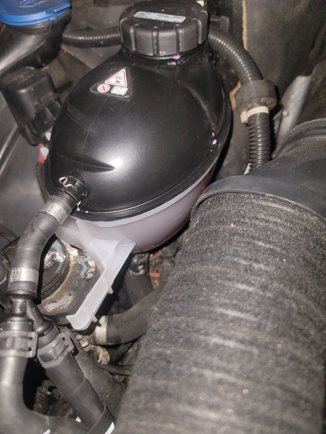

All fixed up. Car pressure tested fine. New reservoir is on. The radiator vent hose was bad as well. Coolant is holding level fine. Luckily just a reservoir and hose it looks like. Thanks all for the help.
