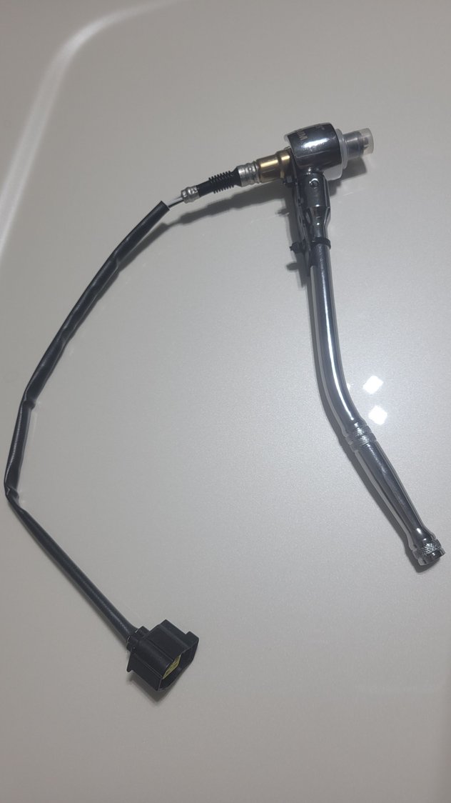

Hello. I got P013E error: "the rich/lean switchover of oxygen sensor 2 (cylinder bank 1) is delayed." The car 2013 cls63has 40K miles, stock. I'm trying to replace this downstream sensor. I can reach the sensor end connect to the catalytic converter but not the other end, the electric plug in. Tiny space, not even with small hand can reach the plug. Do I need to remove anything to reach it? Is there a procedure to do this? Has anyone done this before? I can't seem to find a video for this car.
Can something else cause this error beside the bad O2 sensor? I had all the camshaft position sensors and solenoids replaced at 30k. Just check them recently, they all look nice and clean. Thanks.

Finally I was able to get that connectors out. Take your time and position your hand until you can reach it. When I worked on the passenger side, lie down across the car, my feet facing the drivers side. First i slide the wire off the lower track and then the connector off the upper bracket. Have the new part on your hand to figure out where and how it connected. On the driver side, I had to remove the bracket that hold the catalytic converter to gain access. Anything is possible, just be patient. Good luck.
