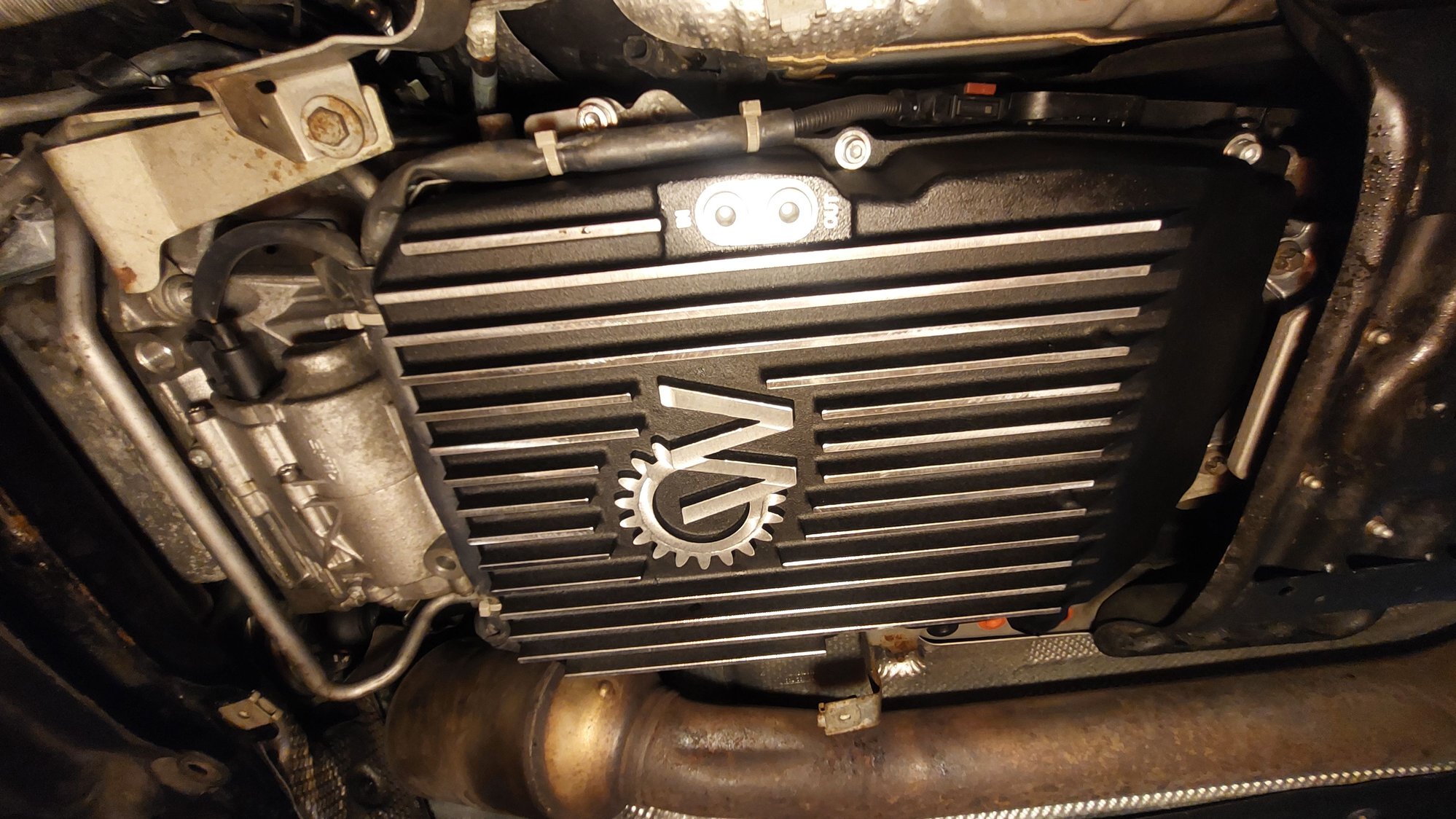

So after years of driving with shudder and jerky acceleration, under low rpm and high torque, I finally got a new wet clutch installed. While I was in there, I decided to upgrade to a Weistec gearbox oil pan.
Hoping that the increased oil capacity will help to keep the temps in check.

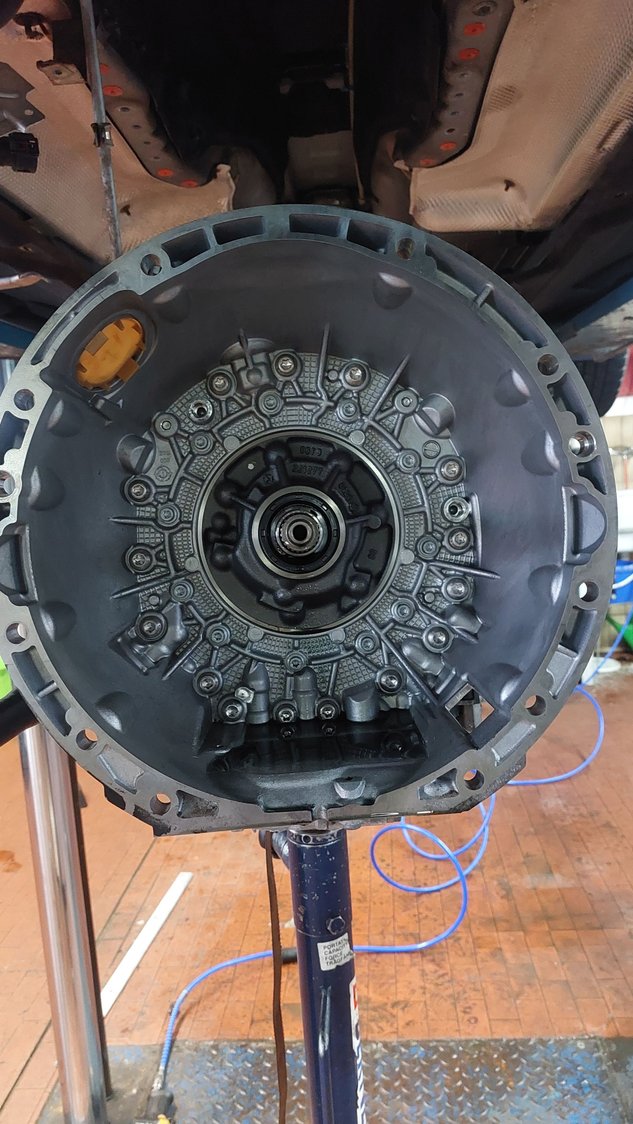

I found a tranny shop which specializes mainly in AMG vehicles. My car's a 2014 model which had the 1st version clutch. Installed is now version 3.

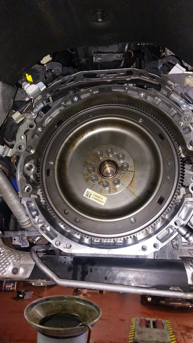

While the tranny was out, I figured we also install a crank seal and new motor mounts. Both were still in great shape at app. 66k miles, so I returned them. We did replace the heater hose connection fitting which passes through the firewall.
The tranny was out after exactly 1.5h. Both downpipes had to be removed, front driveshaft disconnected and a bunch of connectors and mounting brackets. New clutch and oil pan went in w/o any issues. Front diff fluid also got changed.

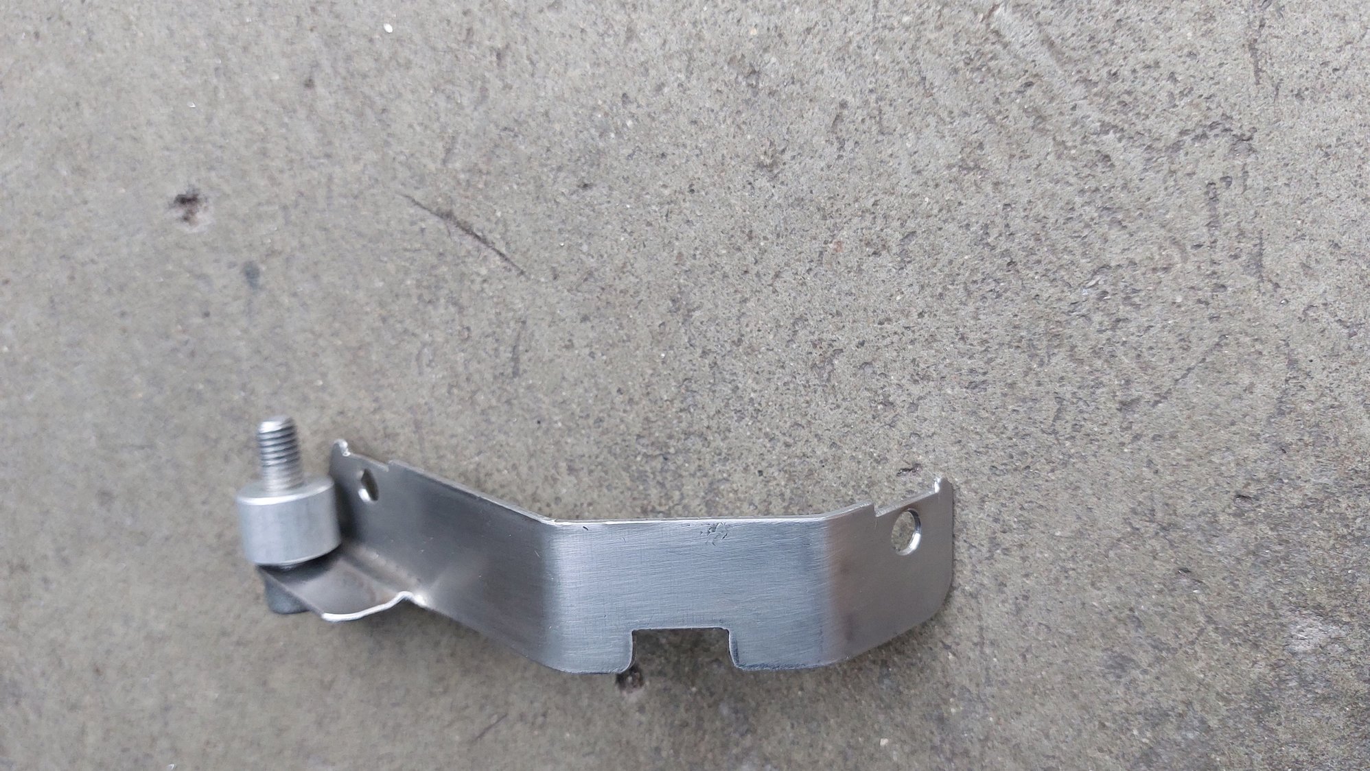

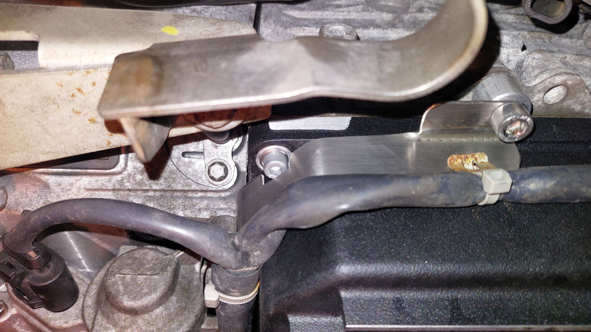

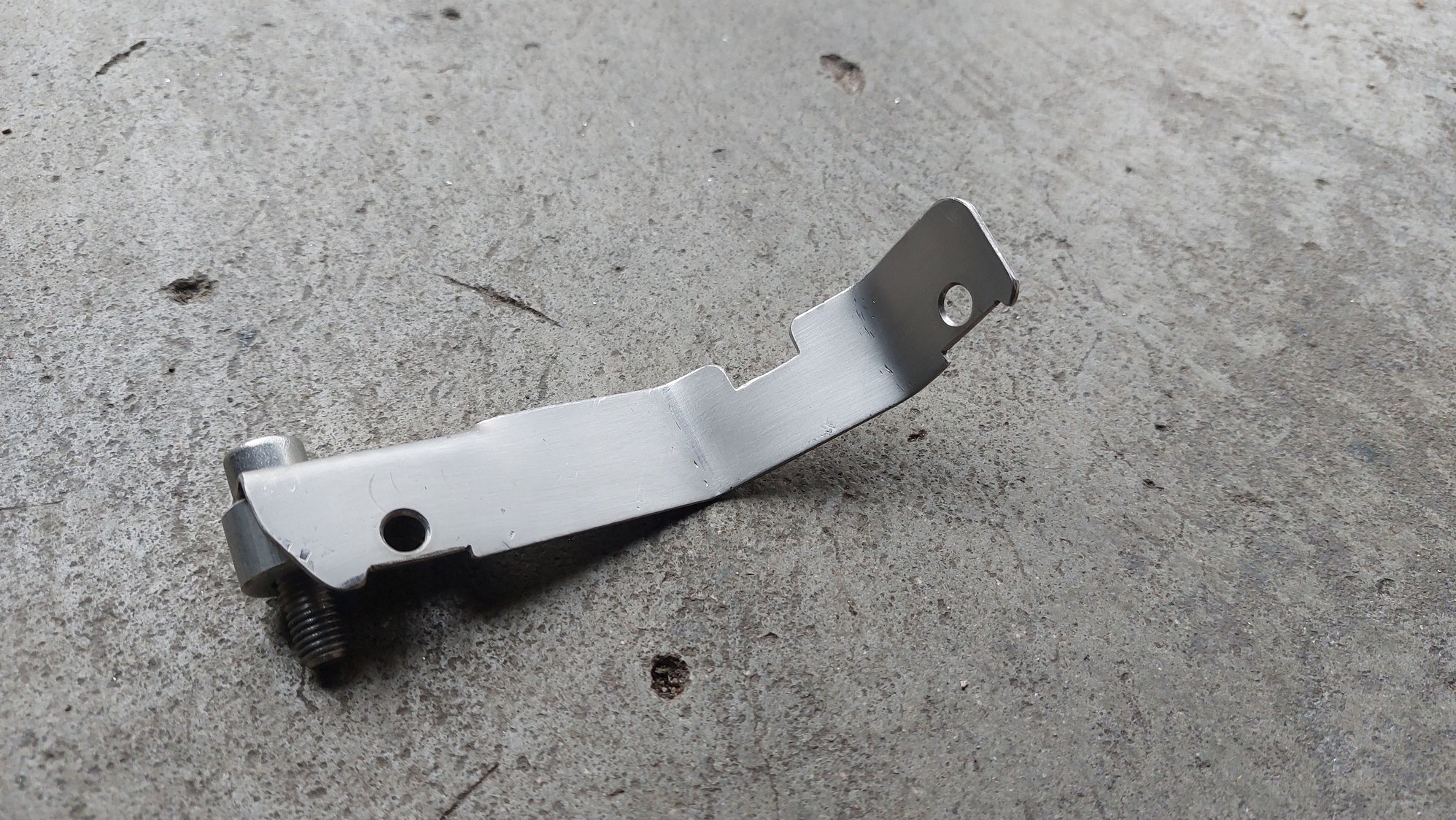

The Weistec oil pan got installed and I immediately noticed that there was no provision made to secure the clips of the wiring harness on the passenger side. I contacted Weistec and their suggestion was to ziptie the harness to the tranny oil cooler line.
That's not how I work, so I fab'd my own stainless bracket.
