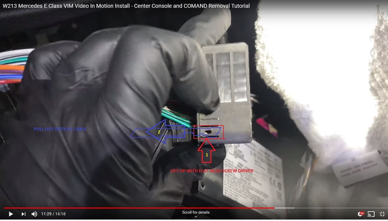

Anyone know exactly how to get the optical cable out? He mentioned in the video that the optical cable was fragile. I want to make sure I do this step correctly.

Optical cable removal is described below with the time stamp for the video below.
All you do like any cable removal from behind the console there is a plastic clip holding a cable wire or harness in that needs to be either pushed in and then pulled out, or the clip needs to pulled up. Here is what I mean. Hope that helps.

Thanks for all of your help Suby01, I got it done! This tutorial was a big help!
