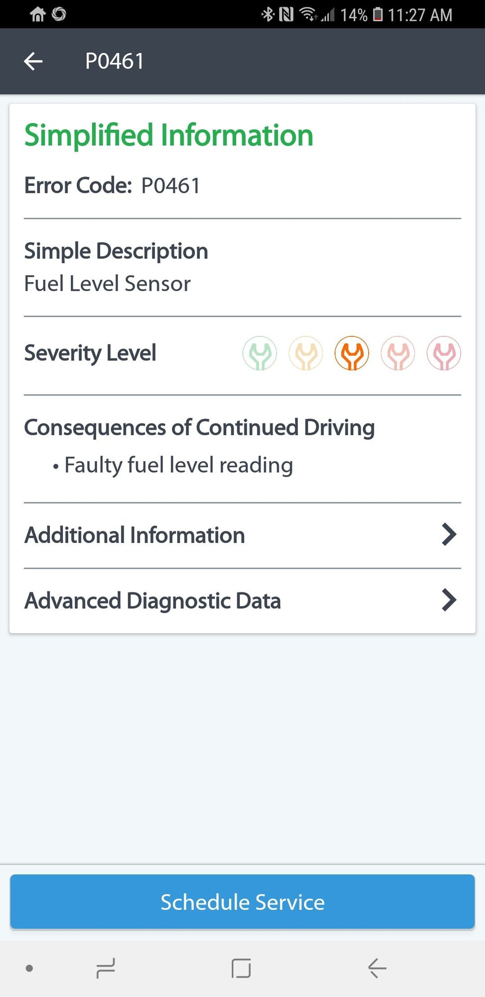

Just got my brand new 2019 E63s had it about 48 hours and the fuel Guage reads empty and got a check engine light. It is not empty and I just filled it up with gas. I have completely complied with the break in procedure and the fuel cap seems secure. Car otherwise drives fine smooth idle etc. Anyone have a similar issue? I can't find my obd2 reader will try to get in touch with mb tomorrow if I can. Big problem for me is there is no dealership here in Kona if it needs warranty work I have to ship it to Honolulu. I am also scheduled for a ceramic coat Monday. Ahhhhhhhhh! Hopefully it is nothing.

Well I called the service center and I am waiting for a technician to cakk me back. Not surprisingly after hooking up my OBD2 scanner it looks like it is fuel sensor. Maybe it's a voltage issue. The battery was critical low on the Mercedes me app while it was in the port. I thought driving about 80 miles would have charged it completely but I hooked up the battery to my charger and it seems that it's only 25% charged. I will fully charge the battery and drive around and see if that does anything. I am a little bit apprehensive about clearing the code without talking to the service center first.

It is called FIXT. I picked it up at target. In any case I charged the battery and reset the CEL and all seems to be well at least for now.
