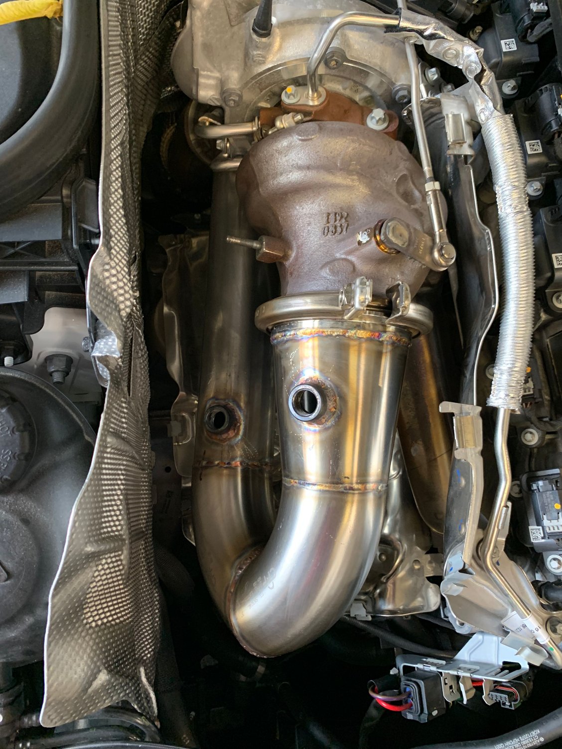

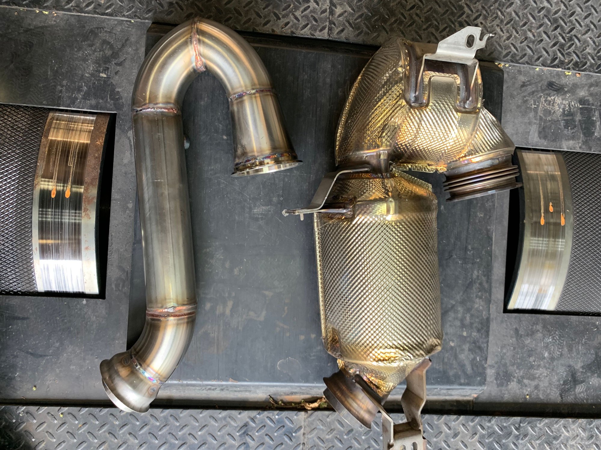

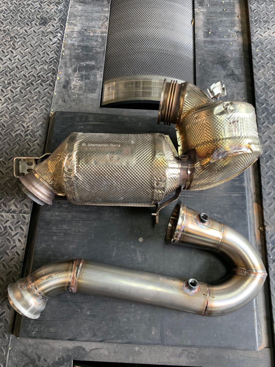

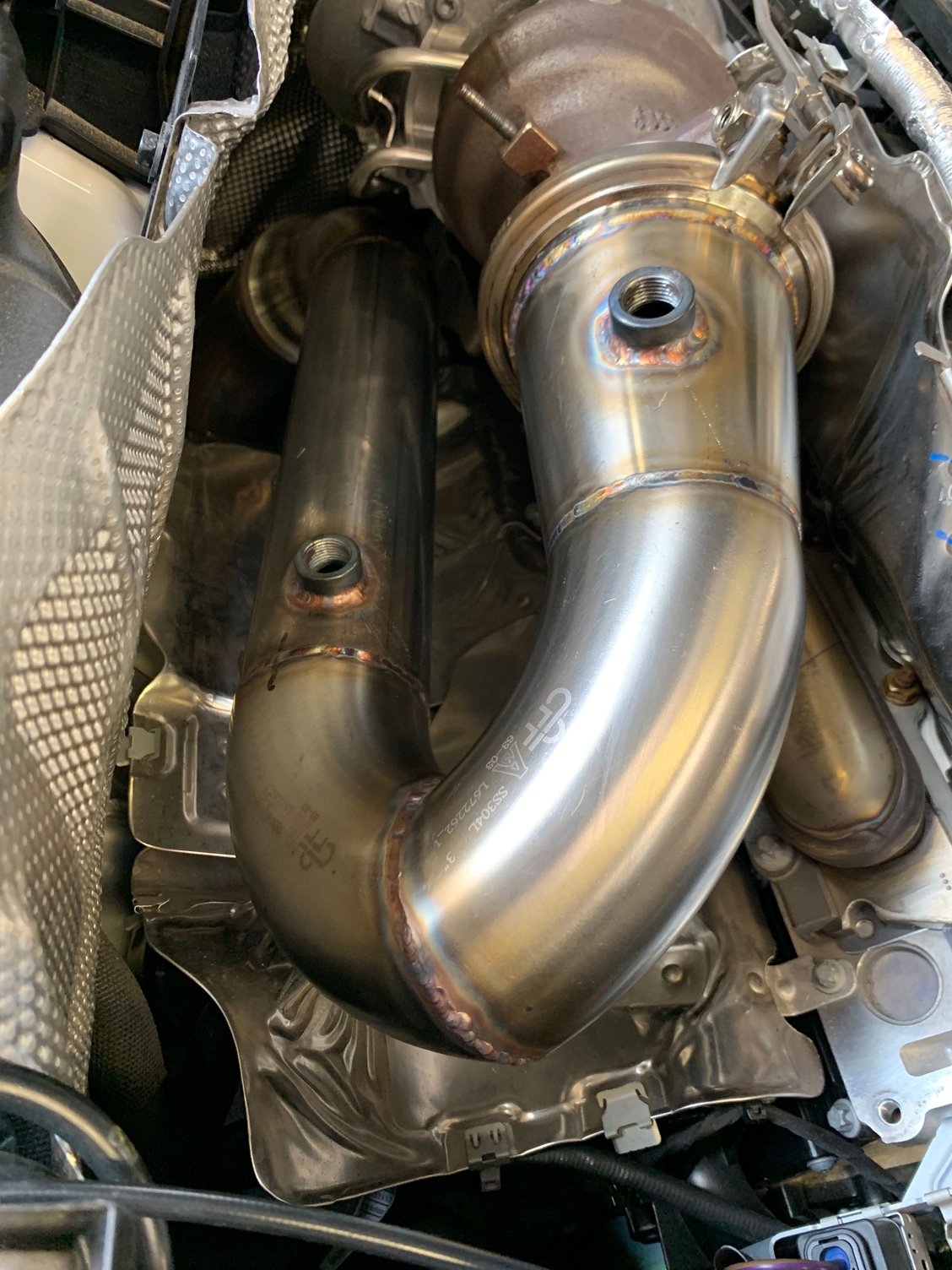

Finished our first E53 downpipe! Check it out and let me know what you think and if you’d want one!

I didnt notice anything abnormal except the size of the cats was huge. There’s nothing else in the exhaust except the muffler

Looks like cat and the GPF/OPF are two separate parts. I wonder if removing the GPF/OPF from the OEM downpipe would not trigger a CEL. Another idea is to wrap the downstream o2 sensor in the catalytic material to fool the system. From what I read the GPF/OPF is killing the sound (high pitch crackles, burbles, etc.) much more than the Cat. The picture isn't clear what's the OEM P/N of the downpipes? looks like A 250 140 02 08 but It's too blurry. I might buy one and mod it for a GT53. I think modding the OEM would be good for people who don't want a cel fix with a ECU tune but want louder exhaust while keeping the air cleanish

Not to rain on your parade. Did you buy that downpipe? That downpipe is not good. My catted downpipe is 3.5 inches all the way to the mid pipe. To choke down the downpipe means to change sound and performance. The outlet of the turbo is 3.5 inches. I went with a free flow cat downpipe that does past inspection and does not smell like gas. The filter is in the old downpipe. It's a 2 parts catalytic converter system. The Tune cleans up the check engine light and free up more power. You don't really feel the full effects of the power until you tune the TCU and CPC. The TCU and CPC controls toque and horsepower. Tuners were tuning the ecu to tricking the TCU and CPC into increasing the horsepower. This cause transmission slip and after the CPC operating system figured it out it decrease the power back close to stock to save the transmission.
