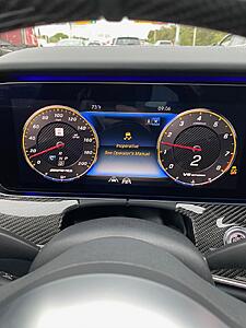

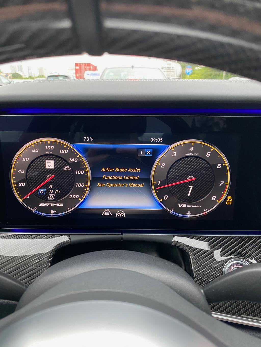

On my way to the dealer this morning various assistance systems became inoperative while I was getting honked at for having brake lights on while driving. The car is at the dealership now getting diagnosed. Not a fun ownership experience so far.

Dec 20, 2019 | 01:37 PM
Sucks to be driving a new car and all those electrical gremlins appearing already. My ML had those exact warnings awhile ago and dealer determined it was a wire harness that was bad. They took off the entire front bumper to replace that wiring harness (performed under warranty) and so far so good. Good luck with yours.
Reply 0
Dec 23, 2019 | 07:47 AM
Turns out the fix was indeed to replace the brake switch. They replaced the switch and all issues are gone.
