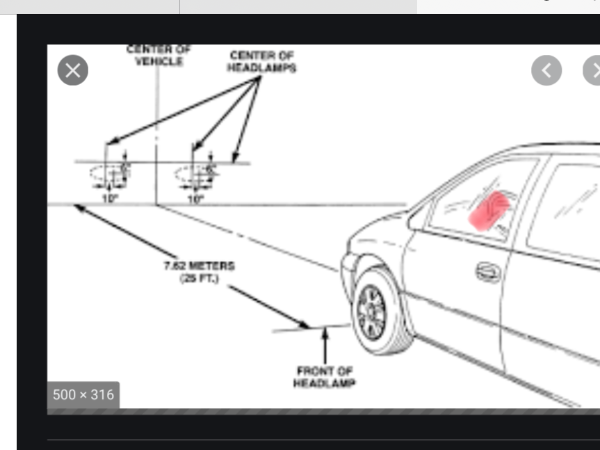

Great description.
However, to prevent people from randomly turning the alien wrench and potentially aiming the beam down to the road, or up to the stars...
Believe there are few important details - who knows the correct distance/dimensions for E63 headlight adjustment?
