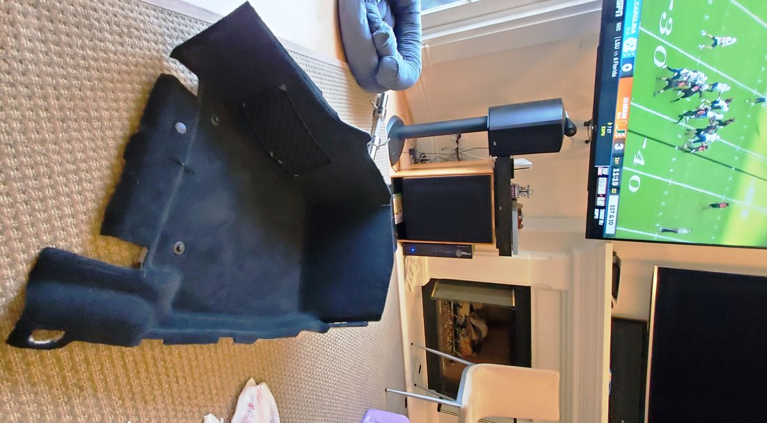

Does anyone know how to remove this? I am changing my CPC, and need to remove the passenger footwell carpet to get to the CPC. I removed the sill, but it looks like the seat framing needs to be loosened?

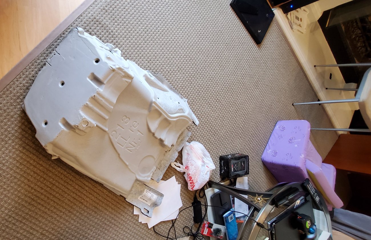

For those who might wonder how to remove the passenger footwell carpet, it is entirely one unitary piece having a foam covered back. I have the acoustic package, which probably at the very least, includes a denser foam and is fairly heavy at around 8 lbs. Anyway, this shell piece pulls out by simply cranking it out. At first, I was a little worried about pulling on the edges to fold the foam and carpet over, but just fold it over. It is going to be a PITA to put back in, however.
