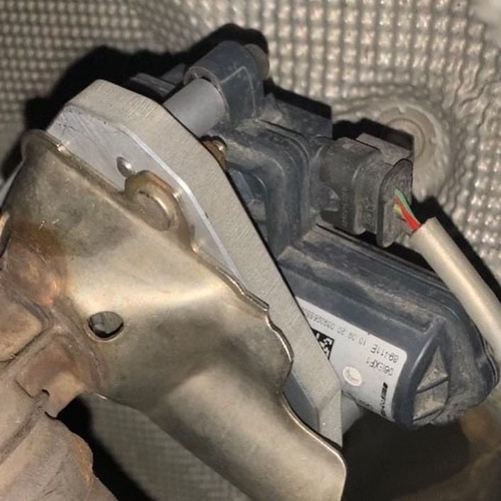

Their bypass essentially allows functionality of the exhaust flap actuators, while flaps can be set in any stationery position - for me fully open; so that reduced power mode caused by the stuck flaps goes away. Another cool thing is it can be easily reverted back to ‘stock’ for when needed to take back to the dealership for warranty work.
The kit is pretty neat.

Here are some pics from my car:
Oh very cool. So you can manually open the valves by hand, and then this kit would still connect the actuators to the car so the car thinks everything is plugged in like normal?
yeah pretty much, in simplest terms

They are saying i need both back boxes replacing costing around £3000. Looking at your pictures i thought that i could just unbolt them and oil them up.
you could actually remove the black boxes (held in by little bolts) and manually open and close the flaps. I imagine you can grease these flaps with some high temp grease to stop them from sticking. Wish I had tried that before buying a new exhaust
