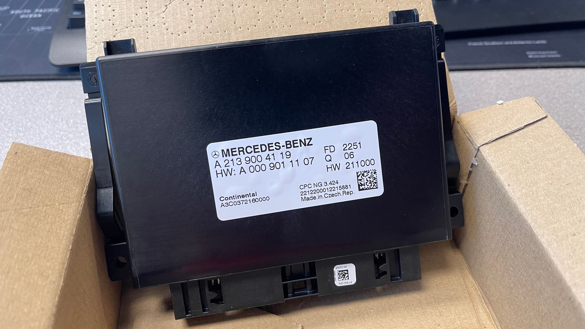

I don't have any proof but in my research all the CPC does is is remove torque limits, with a few options like "cooling management" which I think just runs the IC pump more, and programming the Exhaust Flaps to stay open if you want.
I also don't have any proof but heard through the grapevine Mercedes is onto the CPC thing and there is a shortage of spares and they are getting harder to obtain by tuners.
Because I believe CPC are a commodity with very few parameters to change I picked one up from Black Boost. To me they were the cheapest trusted "brand name" one so I snagged a unit from Jose at Boosted Benz https://www.boostedbenz.com/ just in case the rumor of CPC parts shortages turns out to be permanent and true.
Also one of the cars on here ran a 10.9 with only Black Boost CPC and PTG Intake, and a 10.3 with Black Boost CPC, ECC ECU, Edok TCU and PTG intake so I am not overthinking my mods, I'm just gonna stamp that out again and hopefully it's repeatable. That list is my personal opinion of the best of the best in each area of thing.
My module:
