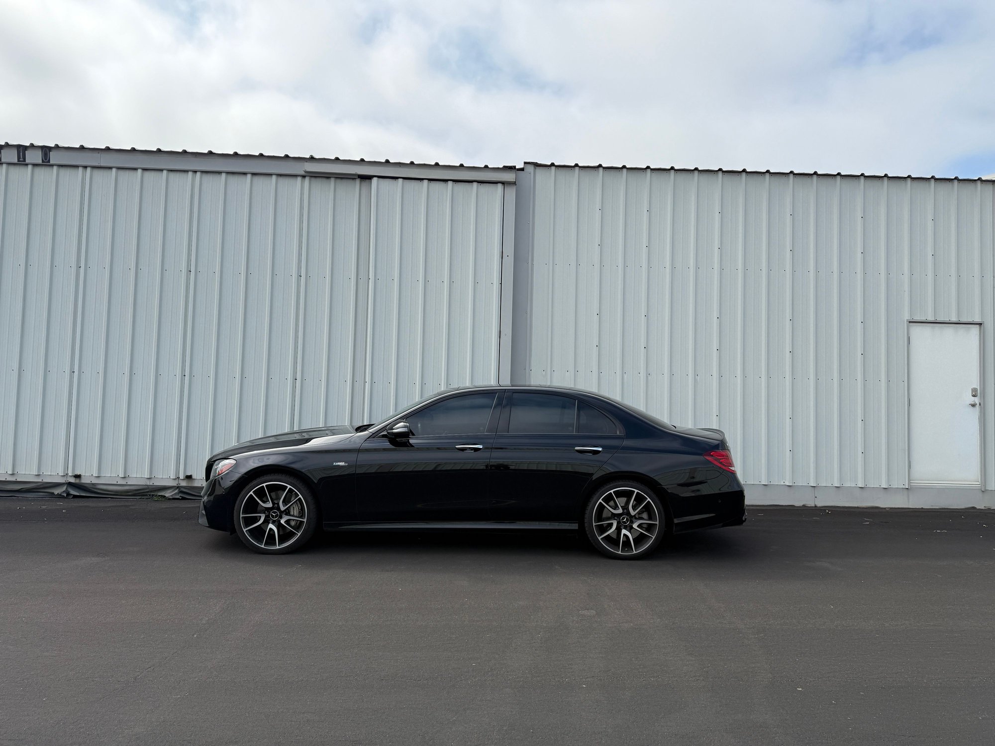

Originally Posted by Cosworth2000
For our E53, our 20's are
Front: 245/35/20 8J19 ET20
Back: 275/30/20 8 or 9J ET49
19' Winter Tire / All Seaons / Summer Performance
Front: 245/40/19 8J19 ET20
Back: 275/35/19 8J19 ET49
do you know the stock wheel sizes and offsets for these wheels? they are the OEM 20's
you said 8 or 9 so i assume that i have 20x8 front and 20x9 rear?
i had a pothole hit looking to switch to 19" and trying to confirm offsets and if i'm gonna need spacers for the wheels i found. they are 19x8.5 ET 34 and 19x9.5 ET 38 i believe. so i would be same specs on the front with a 15mm spacer and the rears would be out ~12mm. not sure if that is acceptable on the car given the air suspension but it's fairly minimal

Does anybody know the maximum diameter we can run on these? I had yet another rim issue (bent slightly) which is making me realize unless I change to a 19" i'm probably going to be dealing with this forever
I'm looking at going to a 19" wheel AND increasing the diameter. Looking at something like 245/45R19 and 275/40R19 which would be 27.7" diameter (F+R) instead of stock 26.8" F/26.5" R. that would give me nearly 1" additional sidewall and hopefully mean i'm not going to keep damaging wheels and tires
