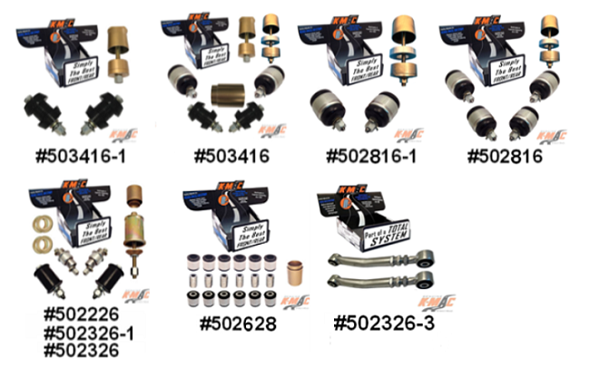

​​​​​​​Yes a prestige make and a performance AMG model as well.
But the methodology is basic - it is all to do with cost savings and the ever increasing speed of new car assembly lines. STOPPING TO ADJUST FRONT CAMBER AND CASTER ALONG WITH REAR CAMBER IS NO LONGER AN OPTION !
NOW CAMBER IS “THE ONE SETTING” - TO SUIT SHOWROOM HEIGHT CONDITIONS.
No longer able to adjust tire contact angles, spread load more evenly. Excess edge load can also lead to higher impact, ruptured side walls and rim damage.
THE OFTEN QUOTED RE ASSURING WILL CARRY OUT A “FULL FRONT & REAR ‘4’ WHEEL ALIGNMENT” - is now only TOE “directional” adjustment. New car industry’s best kept secret !
NO MORE IS THERE “ONGOING ADJUSTMENT” to cater for day to day commuting, encountering excess passengers side edge wear through high cambered roads. Wheel squat and resultant edge wear through altered height from lowering or extra passenger loads. Fitting wide profile tires. Curb knock damage.
While Track days - being able to dial in extra negative Camber to significantly reduce understeer in the pursuit of hitting those corner apexes every time and going deeper into the corners with increased traction and braking response.
With Dealers noting, agreeing re the excess edge wear - but only can offer / try and placate by stating - “alignment is within the factory (broad) specs” !
WE SAW THE NEED THEREFORE AND MANUFACTURE FRONT AND REAR BOLT-ON KITS (designed so no special tools required or need for arm removal to install).
FRONT KITS PRICED FROM $345 - less than cost of one quality tire !
FIX IT RIGHT THE 1ST TIME - W213 MODELS (ALL) SEE SPOILER
