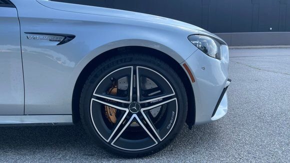

A Cete height control module will raise it an inch or more.
Also just pushing the stock raise button.

@I.T. Guy Thank you and really appreciate the pics! The +/- 30mm was measured with the wagon at max height.
