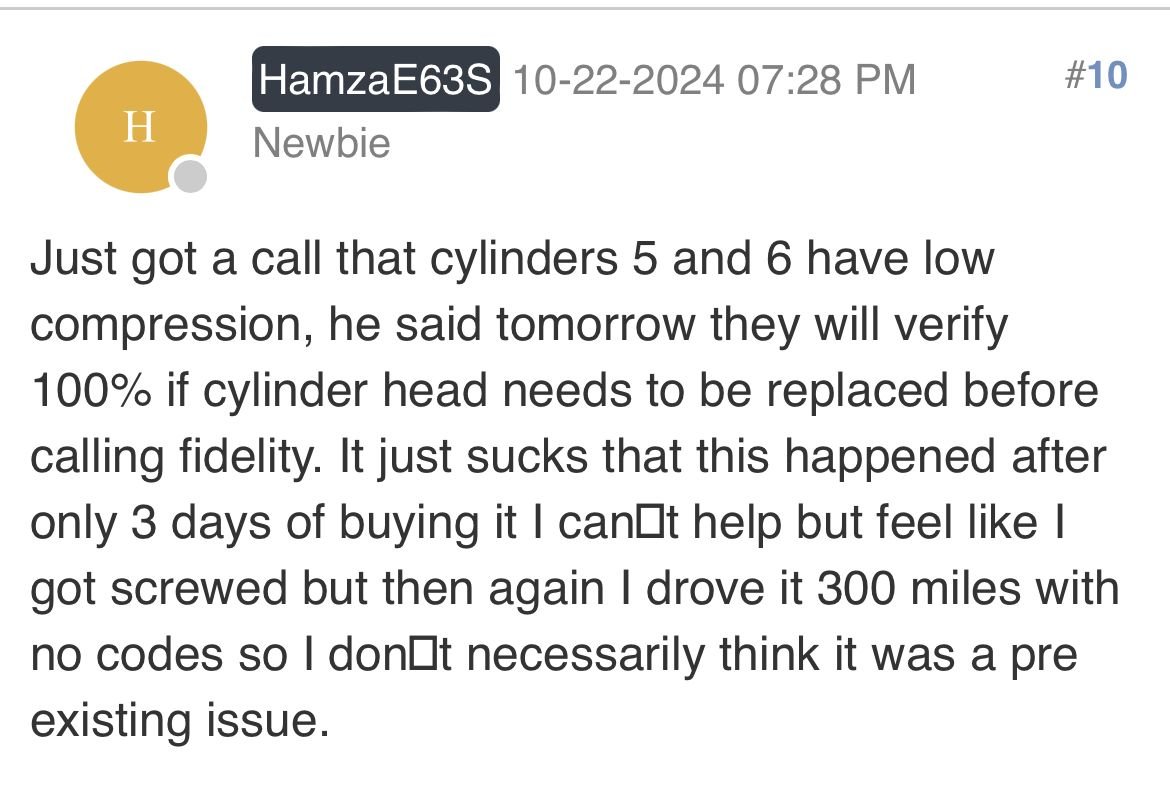

Originally Posted by HamzaE63S
Just got a call that cylinders 5 and 6 have low compression, he said tomorrow they will verify 100% if cylinder head needs to be replaced before calling fidelity. It just sucks that this happened after only 3 days of buying it I can’t help but feel like I got screwed but then again I drove it 300 miles with no codes so I don’t necessarily think it was a pre existing issue.
Sorry this happened to you OP at least you have some warranty on this. PPI is always a must on high performance used vehicles, but hindsight is 20/20. Hope they make this right for you, have you tried reaching out to the dealership you bought this from and see if they are willing to do anything as good faith? May also want to look into your state's local laws regarding this.

The Audi dealership I bought it from are scumbags and refused to do anything all they said was well at least you got extended warranty on it. The GM told me it was a friend of his that traded it in and that the guy maintained it very well. I already filed a complaint with the state office and have an investigator assigned looking into all the paperwork. Now I know for next time to get a PPI including a compression test beforehand.
