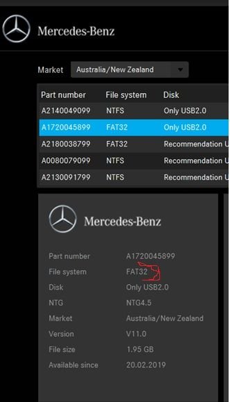

I've had my Japanese E53 AMG Wagon updated and region changed but now trying to get the car to recognise the USB map updates is a massive pain!!!
I've used Download Director and downloaded the correct maps for my NTG and Country,
I'm using a new 16gb 2.0 USB flash drive, the laptop and MB director software worked fine and transferred the new map data onto it
The flash drive is formatted as NTFS also.
When I plug it into the car the system doesn't know there is a USB stick in either port??
I have the system in Menu/Navigation screen so it's ready and waiting but nothing happens.
Am I missing a step here
Wondering if my files are only updates and not a base load to kick it off, like it's missing an .exe file or something,
The car was originally loaded with Japanese maps and I'm trying to overwrite with Aussie maps, could that be an issue?

If your Comand is NTG4.5/7, then maybe you should format the USB like FAT32.
