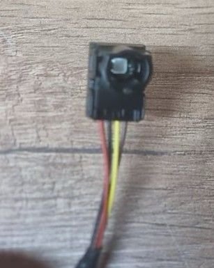

so of note (been researching the living beejuzes out of that particular system.
In most sections, The Ambient light is really one single LED that that is attached to a optical tube to diffuse the light in that "section/region". It is not a very difficult system. Usually if that area is down it is that LED or wiring to that LED.
This of course is not true for the dash where the vent section has two LED lights at each end.

Thanks for posting a picture of the dissection.
