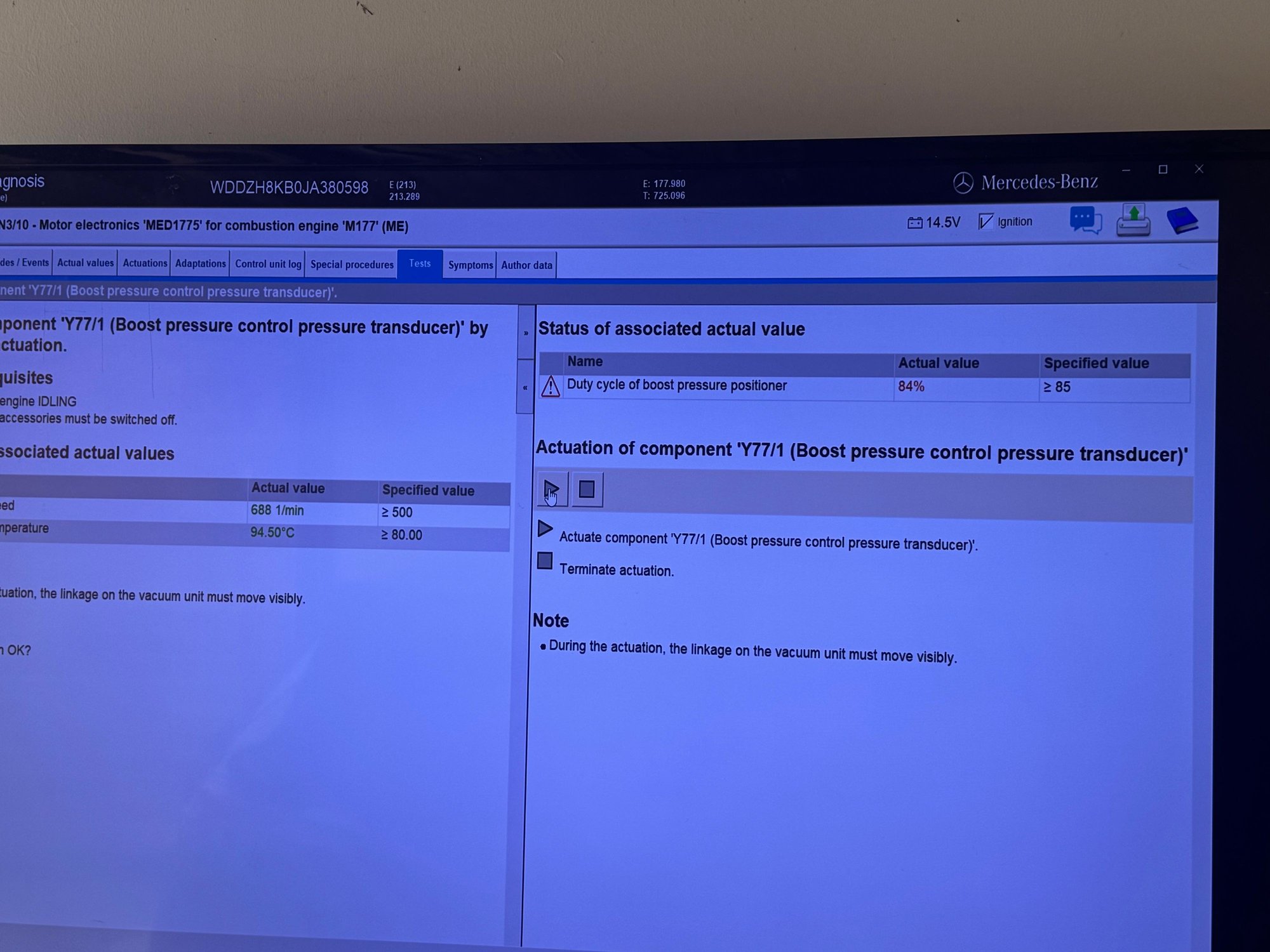

Hello , I’ve had my car for 5 years now and at 89K miles .
last week I noticed poor acceleration and reduced boost , I’m well familiar with exhaust flap issue and ruled out its being a problem next I connected xentry and can see following.
boost actuator position not getting above recommended 85 value ,
So im trying to troubleshoot this next , not use yet if issue is with actuators or vacuum leak, or maybe some boost pressure sensor. Other tests are completing fine.
Was wondering if anyone experienced something similar or could give me an educated guess.

Lately I have been seeing threads on intake valve buildup. If I am understanding your symptoms correctly, that might be a potential cause.

I bought cheap vacuum tester to check turbo actuators , should tell me if it’s opening and keeping pressure in turbo .
