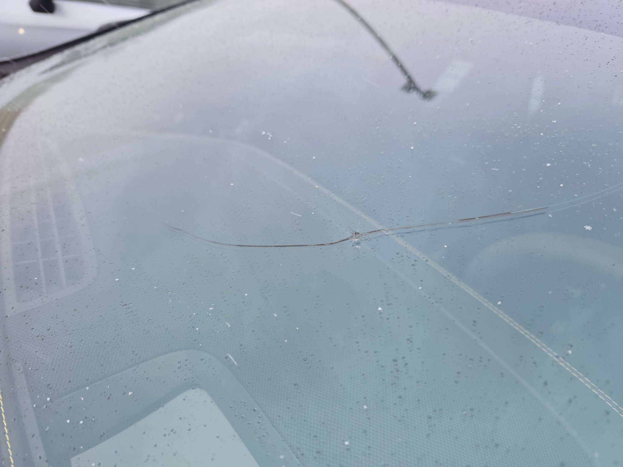

After 156,000+ , I finally took a hit on the windshield and it cracked in a big circle.
I have USAA, and they use safelite...
Couple of notes (for USA customers only)
1. You MUST ask for OEM replacement glass.
2. Most insurances need to approve OEM glass.
Final note: safelite does not have E63s as an option..they have the E43 as the only option. That pulls up the incorrect part number. The E63s only had one option for the windshield...it has the RF/IR shielding. The E43 does not.
The installed glass has Carl Benz paw print, mb logo and most importantly, the rf "openings" exactly like what was put on in Germany.
Time to replace, 1:45 including revalibration of cameras.
