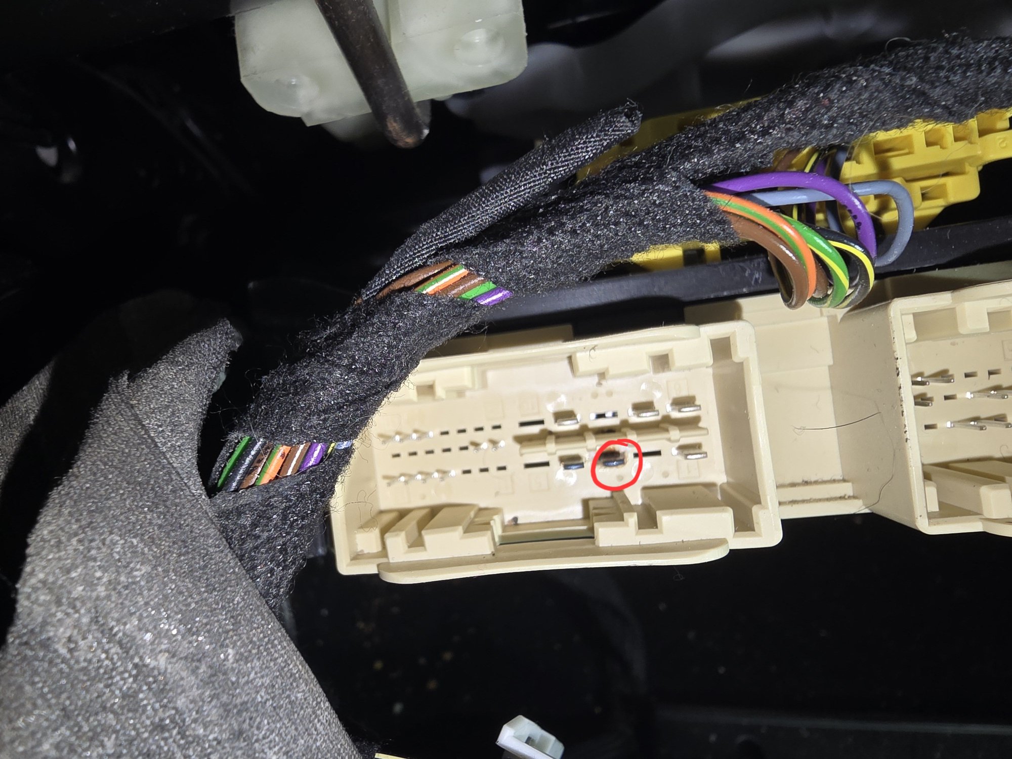

Update:
So finally got around to look at the seat module and connections.
My guess was nearly spot on, bad connection.
The white connector had a brown spot, What looks like the power pin was loose which causes a temperature spike on the contact.
I closed the connector up and now it is working without fault.
I am posting the connector information but the sockets is what is needed...
