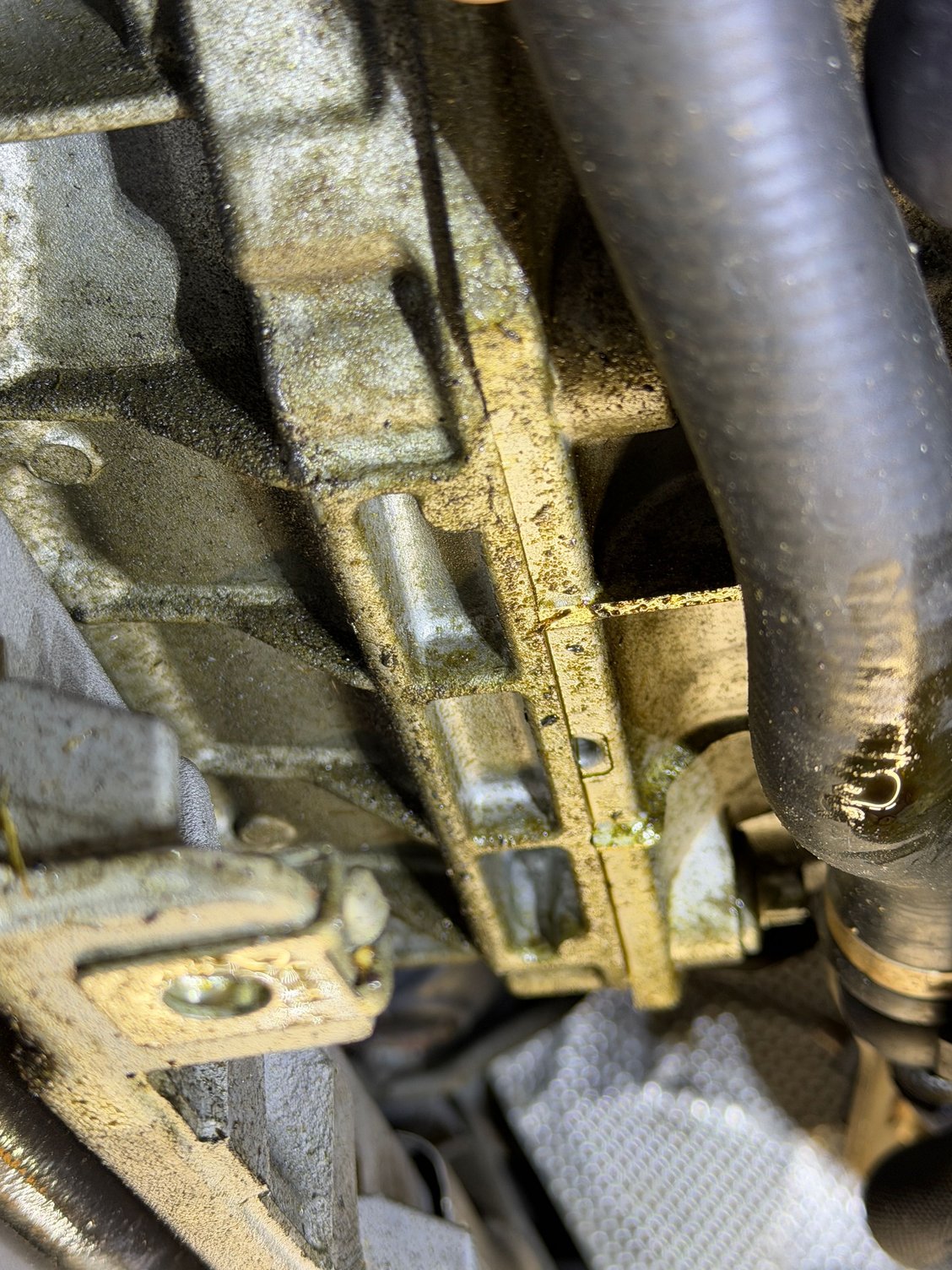

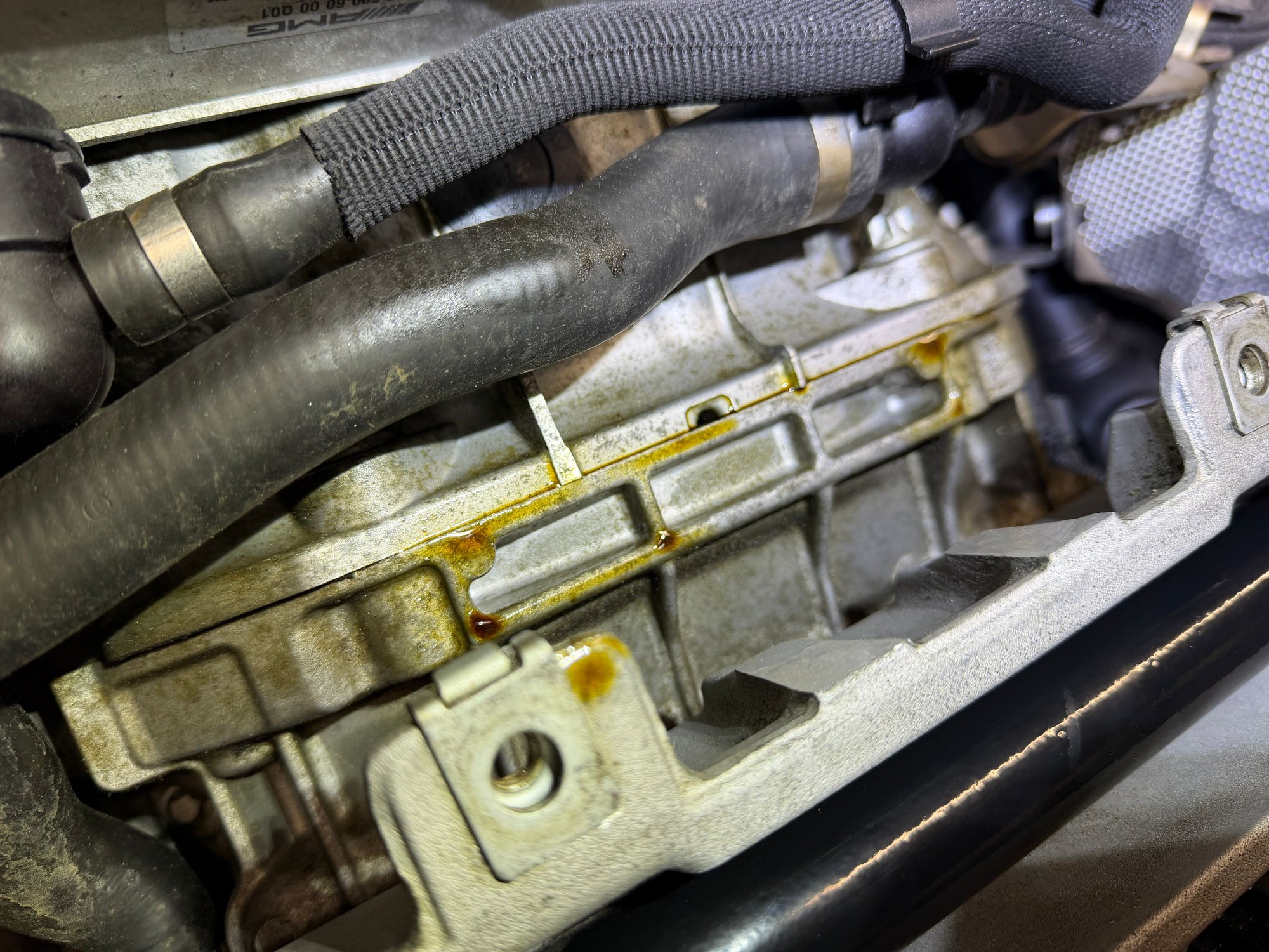

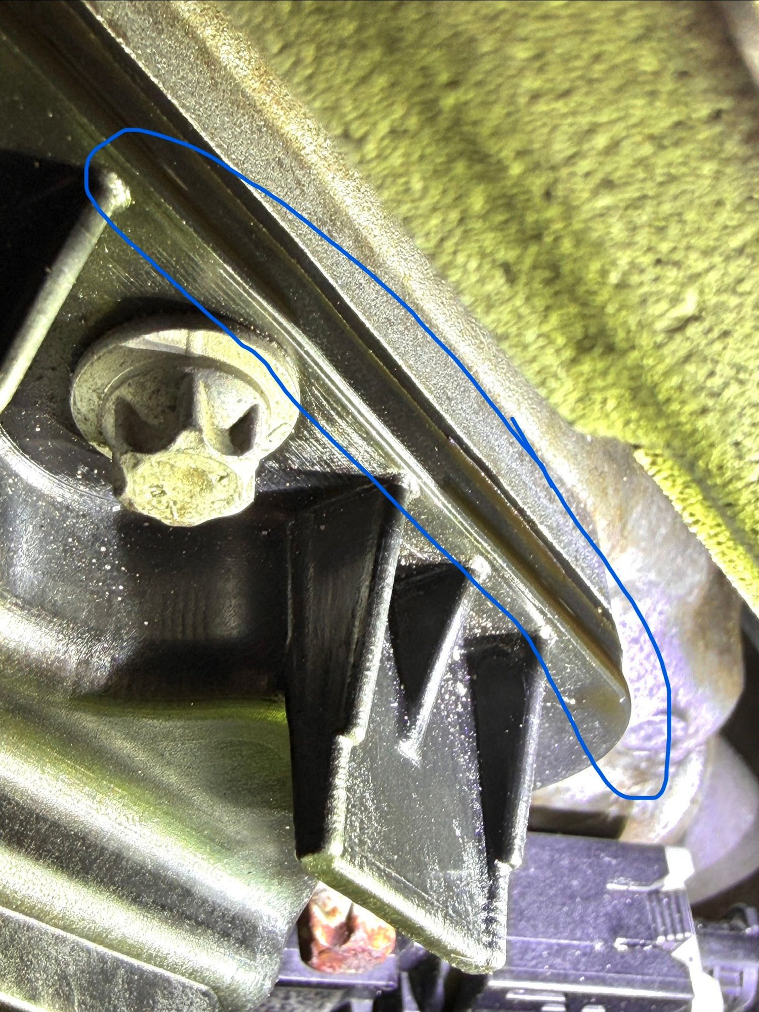

Trying to figure out if this is a failed RMS or something else.
I bought my E63S last fall (~65k miles) and about a month later noticed a decent oil leak. I cleaned everything up to try to track it down, but winter hit and I didn’t get back under the car until now, after a few months and ~3k miles.
I’m aware of the common RMS/AOS issues on these cars. Nothing showed up during the PPI, though I know that doesn’t mean much. Carfax shows a cylinder head replacement years ago and at some point the transmission was removed for unknown work. I may try contacting that dealer for more details.
What makes me question the RMS is the amount of oil forward of the transmission on the oil pan. There’s oil at the engine-trans mating surface, but it doesn’t quite look like the RMS leaks I’m used to seeing (I’ve worked on plenty of German cars over the years).
For reference, I only get about one small drip on the garage floor every 3-4 weeks, but the belly trays have definitely collected oil, so it’s clearly active.
Curious if others with failed RMS leaks have seen oil travel forward onto the oil pan like this, or if I should be looking elsewhere.

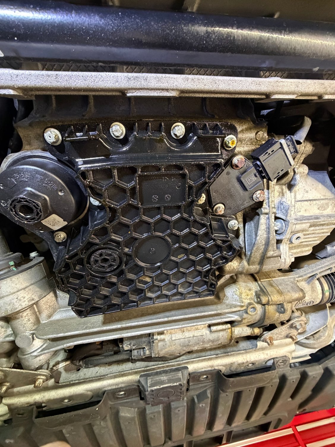

That almost seems like a lower oil pan leak. I would clean everything up again and leave the panels off and see where it reappears. You have to clean everything up though and then start at the valve cover gaskets and work your way down until you spot fresh oil. Does not look like an RMS real as that is typically very apparent at the mating surface between the block and the trans. It typically drips down onto the sway bar and then down to the tray.

My head went to the oil pan as well. I’m due for an oil change so might clean it up and throw a new oil pan on while I’m at it, and keep an eye on it. A new oil pan is less than an hour of diagnostic fee, so it’s not a terrible wager.

@LongRoof88 I wouldn't change the oil pan until you confirm the cause of the leak. Something I've learned over the years. Find the cause, then correct. Don't throw parts at it since you could be creating new problems (a new leak location).
As mentioned by @superpop, I'd degrease and wash the entire underside and leave the under trays off. If you have a leak (and do a good scrubbing), you should see the seep in relatively few miles (or you'll notice more places you need to scrub up with a brush and some Dawn detergent. I've heard of some UV dies people use to better detect leaks but never tried them myself.

Agreed, oil pan.

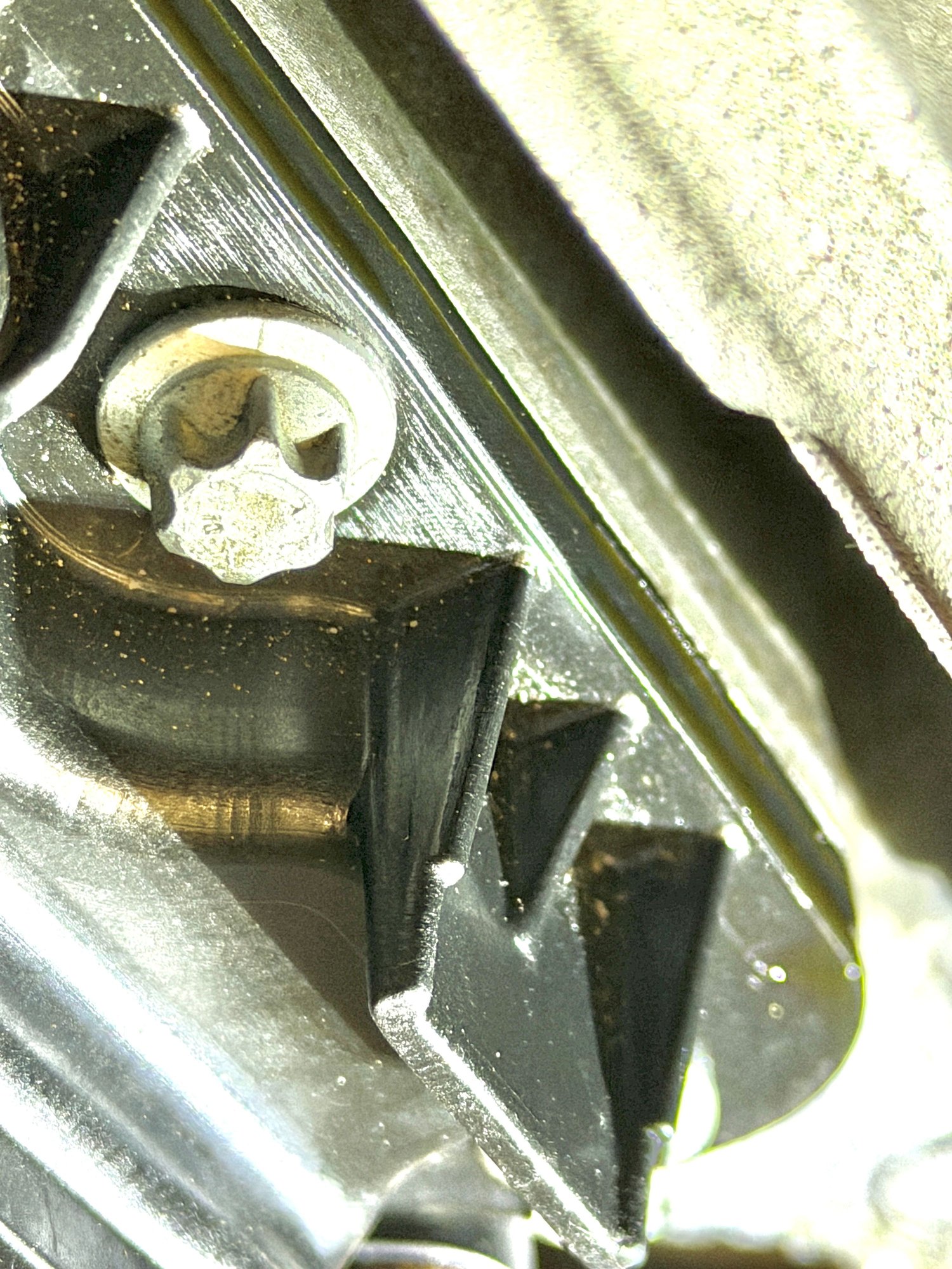

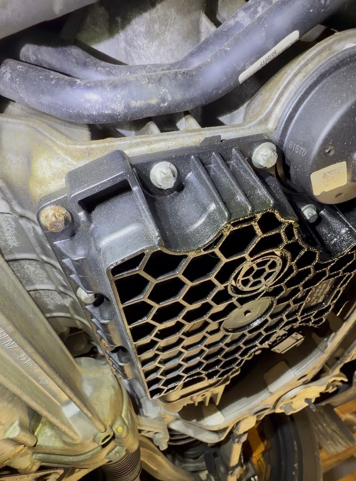

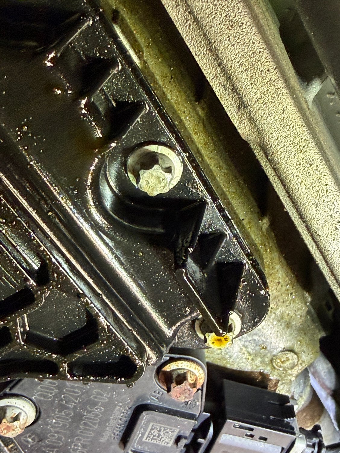

Well, cleaned everything off and took it into town. Ended up having a rather spirted drive back. About 12 miles round trip.
Put it right back up into the air and was surprised to see this much oil. I definitely have oil seeping out through the back of the lower (plastic) oil pan. I tried adjusting the light so you can see the wet film along the back edge of the pan. What I don’t love is seeing that much oil at the trans-engine mating faces. I’m having a hard time believing the seepage at the pan is traveling back and accumulating at the trans that quickly.
It seems I might have excessive crankcase pressure to the point it’s blowing out the oil pan gasket and the RMS?? Oof.
I do have some moderately slow 1st and reverse engagement (beyond what I think would be normal for an MCT, but I’m speculating). Hoping the trans hasn’t also fallen victim here too.
Might be time to button it up and send it to an Indy. Few years ago I would be looking to tackle this myself, but with a second kid arriving in a few months, I can’t give this the attention it needs.
Worth trying to replace the oil pan that’s on the way and seeing I’m still getting accumulation at the trans? But if it’s due to excessive crankcase pressure due to failed oil separators, the pan is just going to fail again.

That is most definitely RMS failure. Pan swap is simple but I would just hand it to your indy and have them swap it when they drop the trans as they have to drain the oil at that point anyway. If it was me, I would bite the bullet and have your indy drop the motor and trans as one and do the following. RMS, OVS, Motor Mounts, Belts, and Plugs. Far cheaper to do this all at once rather than doing it piecemeal. Assuming you have not already done this stuff and that mileage is around 68K at this point. Once you do all of that you should be set for a very long time assuming you want to keep the car for a while. Otherwise you could just fix the RMS and move it along.

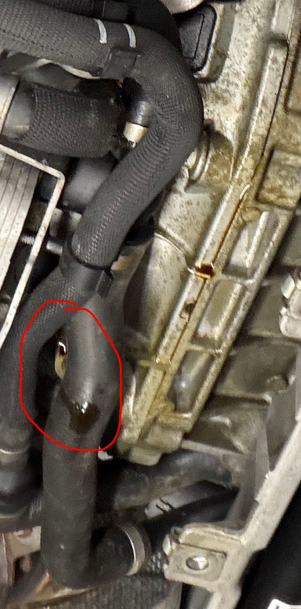

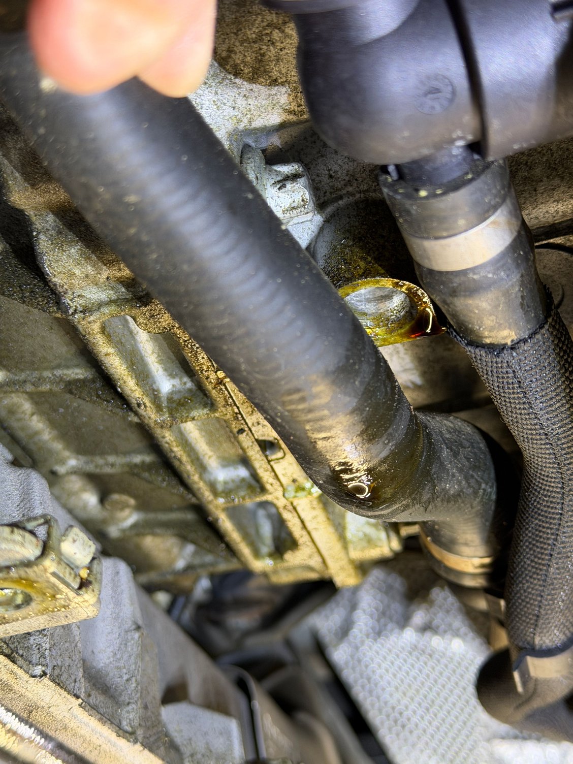

Let it sit overnight and checked it out this morning. Oddly enough there is accumulation on this hose (as was evident also before cleaning), which seems to be originating from above. You can see the light reflecting off the oil right above/between the two hoses on the trans housing, rear of the transmission/engine interface. Was headed off to work so did not investigate further. But has me wondering where this is coming from. Either way looks like at a minimum the trans is coming down.
