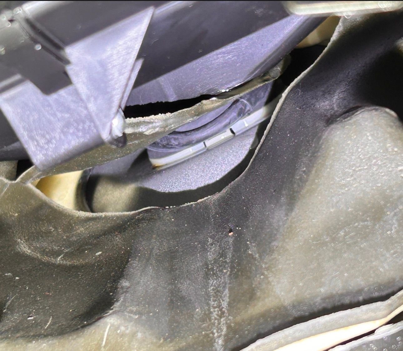

After they dug into it at dealer found a pinched tube for the AC drain has soaked the passenger floor, and there was corrosion on connectors for some of the harness connections. They said extended warranty would not cover it so trying insurance but adjuster told service advisor likely won’t cover it.

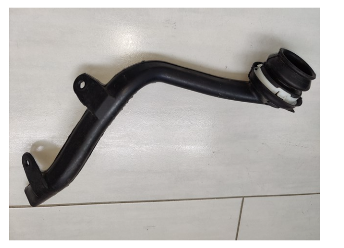

Plenty of MB's have issues with the condensation drain hose leaking into the cabin. Usually the hose detaches from the housing. I'm not sure about the W213 specifically.
The photo above looks like some type of plastic is cracked/damaged. Cant tell if thats the actual hose or something else.

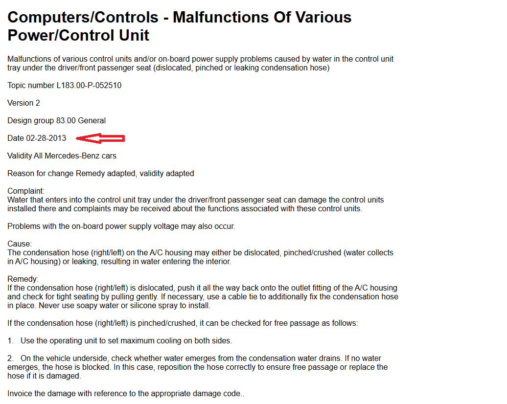

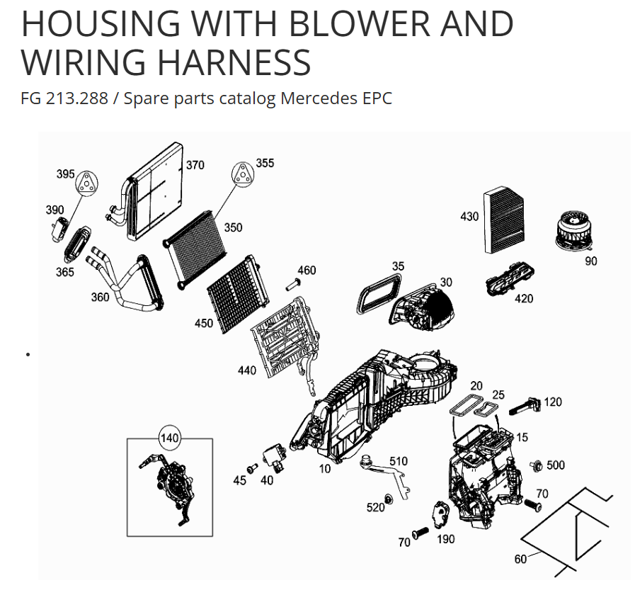

I couldnt find diagrams for an E53 but was looking thru the E63 W213.288 and found the drain hose (510). Looked up the part # and noticed its the same as a few other models like the W204 C63. I looked up TSB's for the C63 and they even have one for the drain hose back in 2013 i'll note below. I skimmed for any TSB's for the W213 about the HVAC and couldnt find anything.
