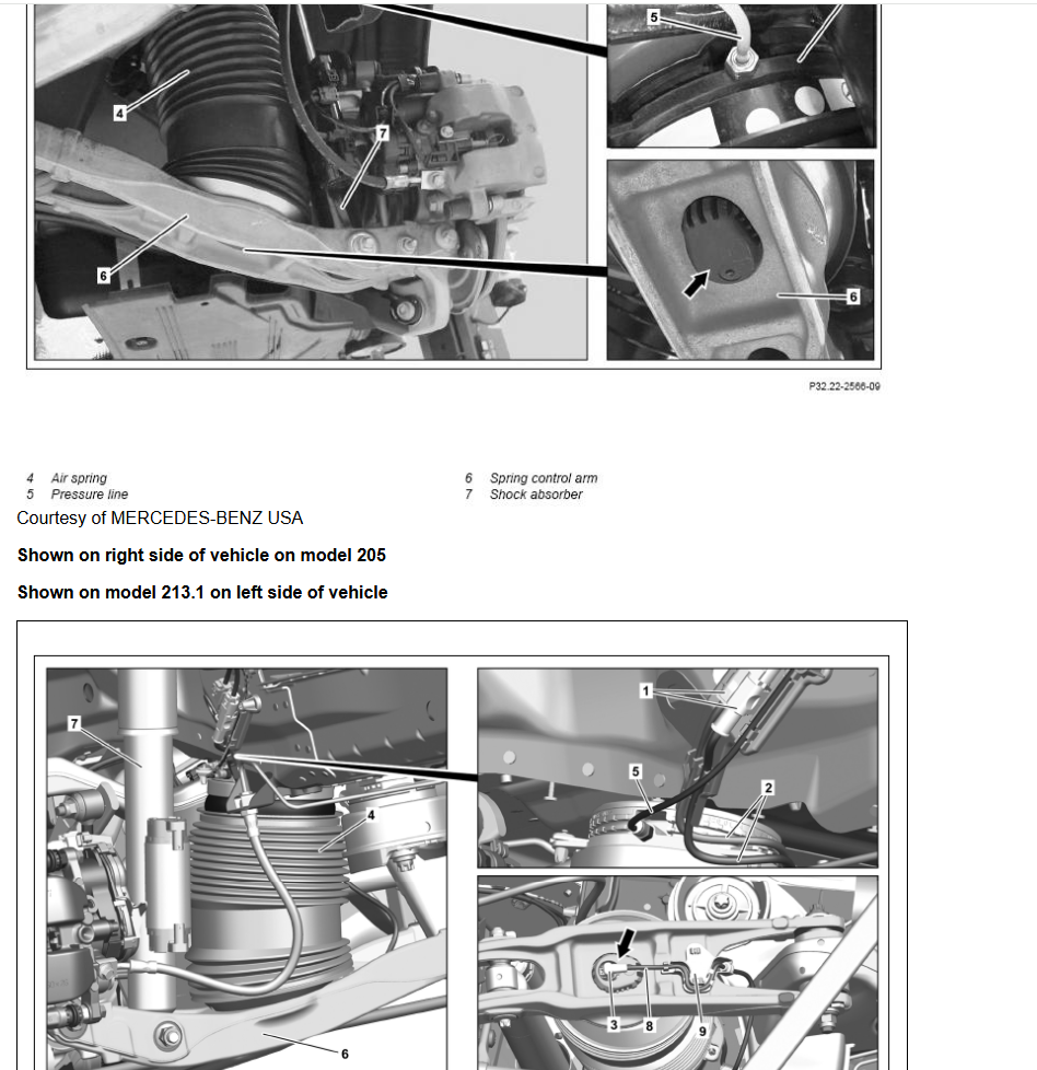

Which part# are you looking for?
I'm not 100% sure of the answer though a quick search of the parts diagrams I do see two different part #'s for each side. One spring has a 205 # and the other starts 213.
They look different from eachother. I think its about which option code you have.
Can see the two different looking springs in a page from the suspension manual below.
