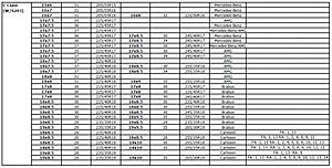

I would like to put the 22 spoke wheels from a SL55 on either my C32 or SLK32. They are 8.5x 18 30mm offset front and 9.5x18 33mm offset rear. Can you tell me if they would fit and recomend a tire and tire size?

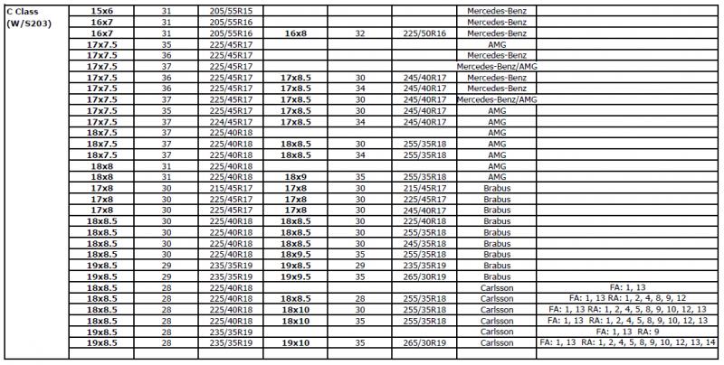

This fitment table says the wheels should work. Some tire sizes are on the chart, too. Check out the Brabus 18x8.5 ET30 + 18x9.5 ET35 setup.
