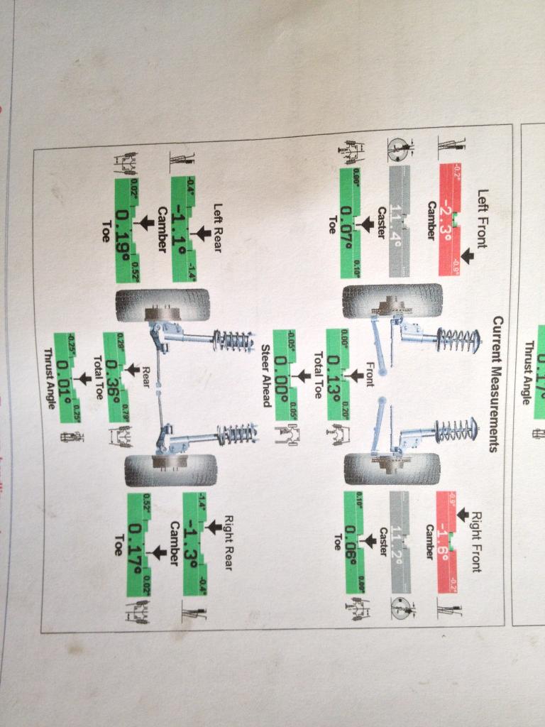

The front is completely crazy. I installed a set of adjustable upper strut hole lobed camber bolts that were supposed to bet me up to 1.75 degrees. Well when I went for alignment today this is the best they could accomplish with the bolts installed.

Anyone have any thoughts? I'll installed the merecedes crash bolts but from what I read they can only net me another .3 degrees of camber play.
Does anyone have any other ideas as to how I can eliminate more negative camber?

It's no wonder - since the mid 90 model’s, there has been no Camber and Caster adjustment facility fitted OEM!
Only current adjustment is front and rear Toe.
To attempt to return vehicle to factory specs to resolve premature inner edge tire wear, improve traction, fix steering pull, increase/decrease negative Camber the only current alternative for Camber and Caster is to fit offset, slotted bolts. But these are inaccurate one only position bolts offering a minimal .3 of one degree adjustment (3mm).
Many owners continually change tire brands or go from one MB Dealer or alignment shop to another trying to get it right/fix the problem.
The current K-MAC W203 kits have up to 3 times the adjustment of the one position offset bolts (both Positive or Negative). And unlike these offset bolts they can be accurately adjusted - under load, direct on alignment turntable (no need to remove and reinstall each time).
For the rear, similar kits for precise Camber adjustment with additional Toe to compensate for the new Camber facility. Unlike the alternative adjustable Camber arms K-MAC rear kits do not move top of tire outwards - this reducing all important clearance to outer fender when adjusting to fix premature inner edge tire wear/improve rear traction.
Also at K-MAC we have developed these kits with long life maintenance free elastomer bushings with just the right amount of flex to get power to the ground, maximum traction. Unlike the spherical bearings used in Camber arms that soon pound out allowing metal to metal contact.
Bonus with the four front and four rear bushes is that they are designed with twice the load bearing area and also replace the highest wearing suspension bushings. And with K-MAC no special tools are required to fit.
