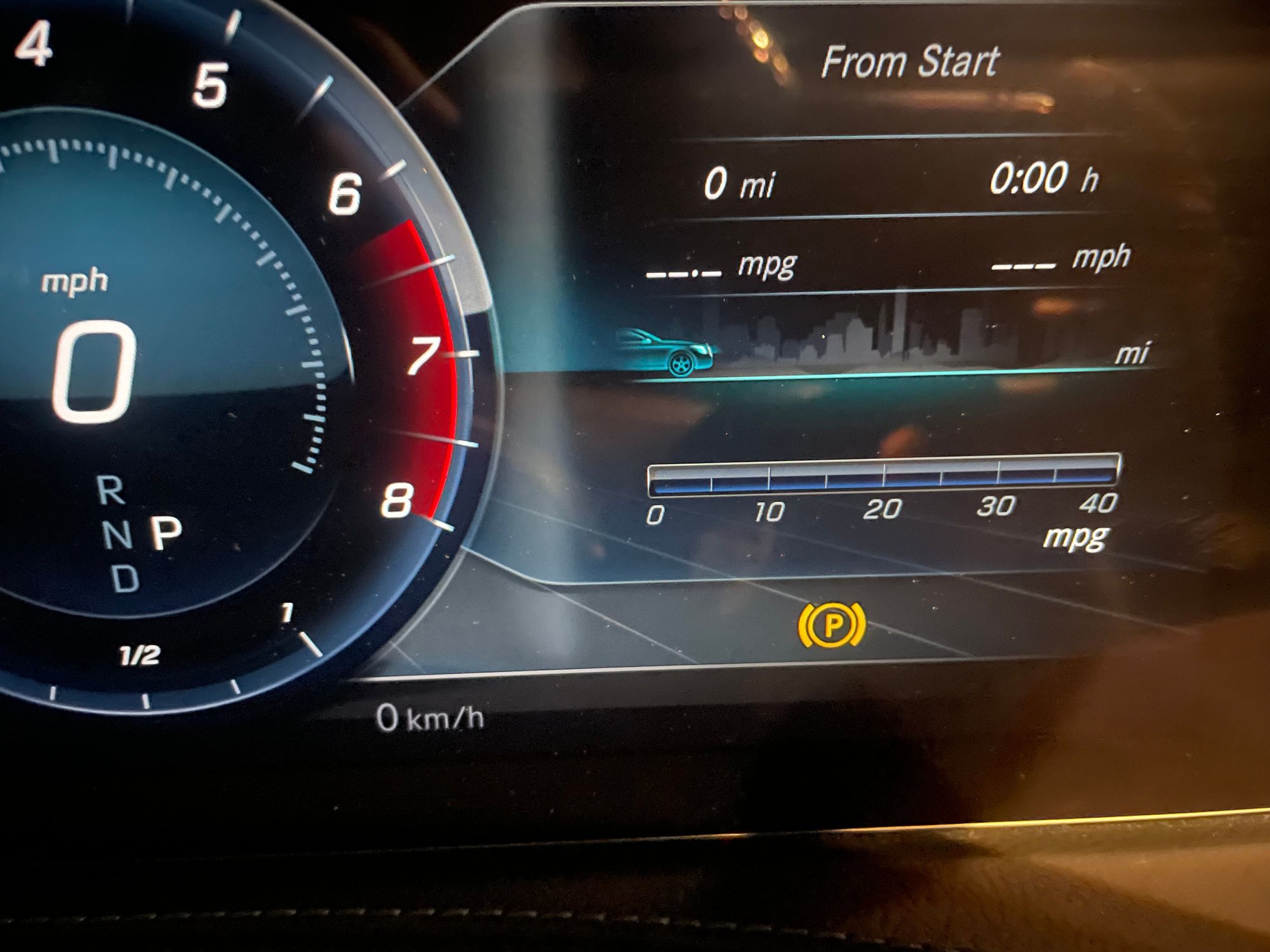

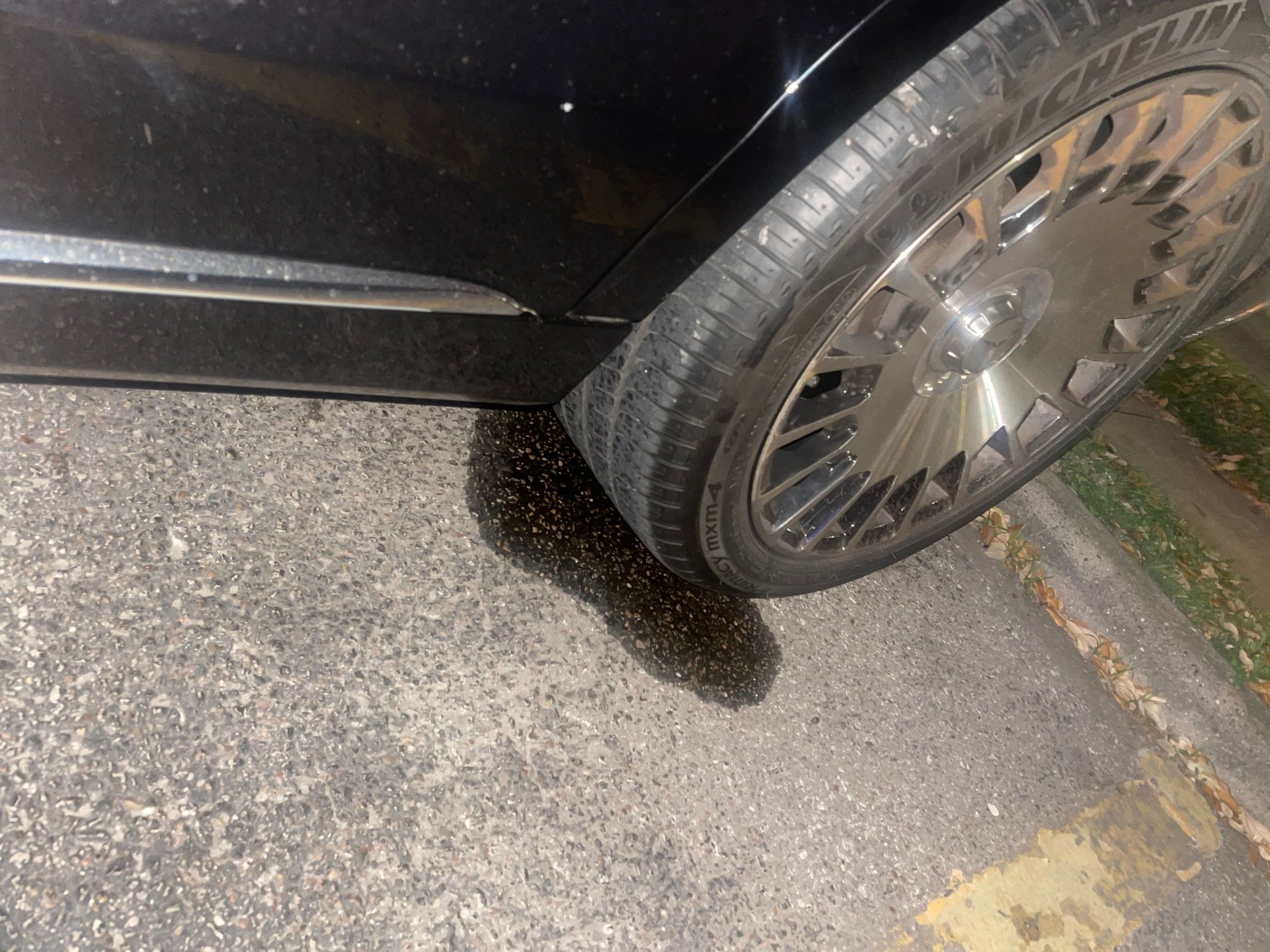

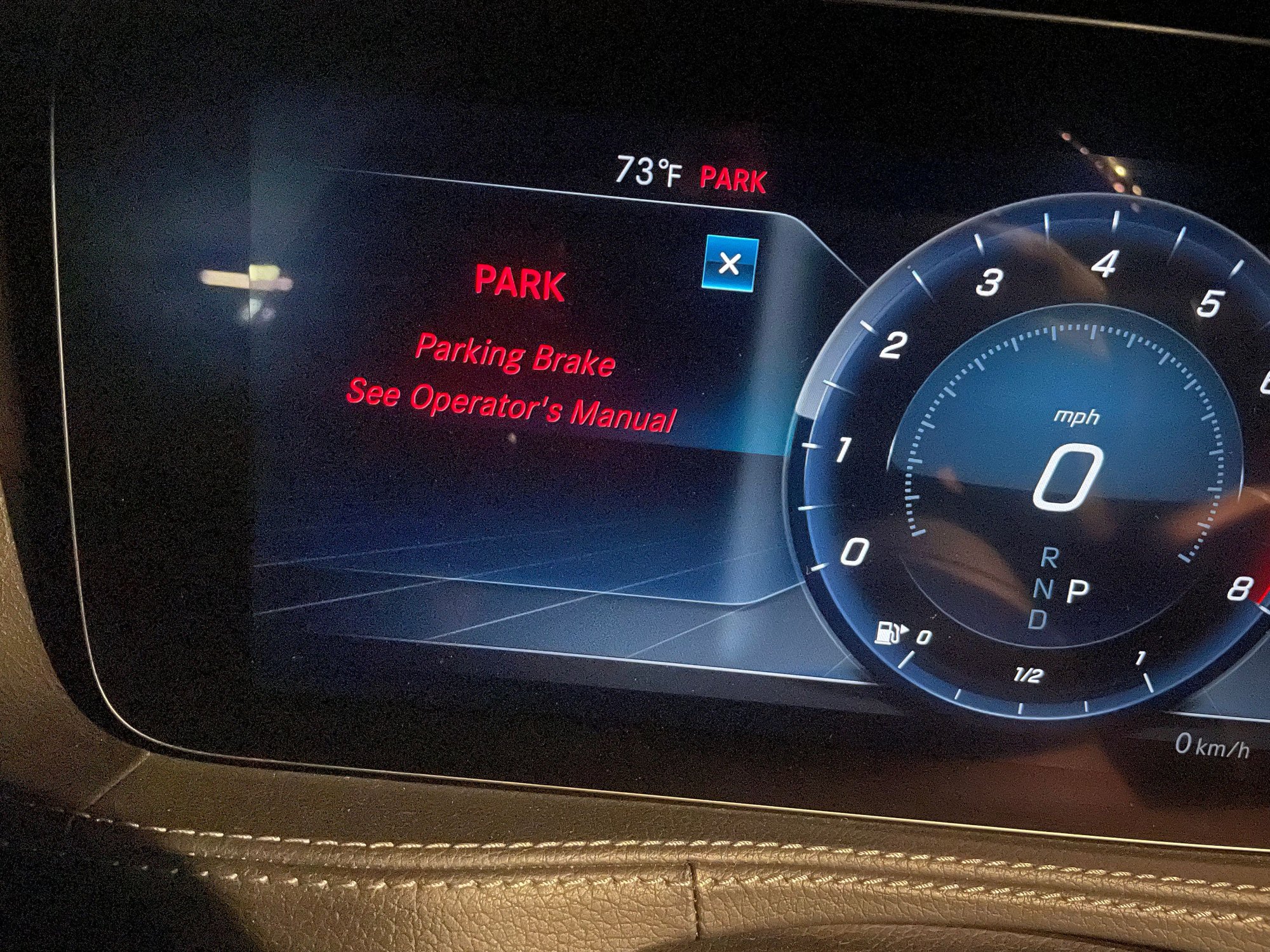

Hello. I own a 2019 S-Class 560 4matic. And back brakes/rotors are needed. The front brakes and rotors are new for sure. But when I started driving I had to push brake to the floor. There was fluid that came out of the back brakes when I eventually parked it was on ground and now it won’t shift to neutral or reverse because it is not reading me pressing on the brake pad. Is there anything manual I can press or process to shift it to neutral or reverse
Parking brake fluid while car was parked
Displaying of my dash while car is running
Emergency parking brake came on
please help

Check your owners manual to see if you have a manual brake release on your car. Some OBD scanners have services to release parking brakes. Why do you have fluid spilling out?
