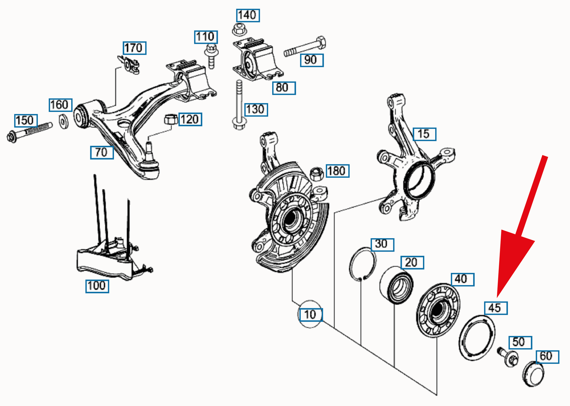

I've just replaced the wheel bearing on the front right of my 2014 W176. When I removed the old one I forgot to make a note of where the centrifugal seperator was positioned. It's a piece of plastic with ridges. I'll post an image to show what it looks like.
I have now pressed the new bearing into the knuckle and ready to press the hub back into the knuckle but for the life of me I can't remember where the centrifugal seperator was on the old one. I have a parts diagram but it's not clear where it goes. Does anyone know where it should be positioned please. I am 99% sure when I took it off it was on one side of the bearing but I can't remember which side. Should it go between the bearing and the hub before I press the hub back into the knuckle. Any help will be massively appreciated.
