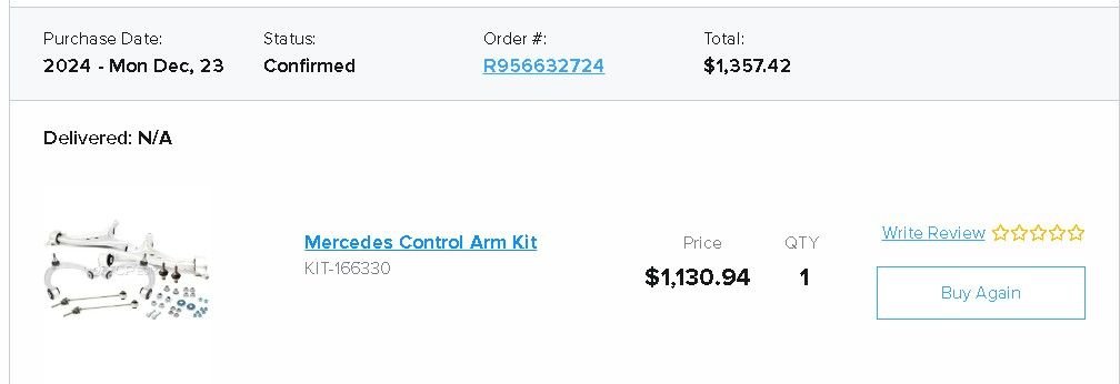

Maybe, maybe, maybe to their defense...I had a wobble for a long time we checked everything. Months later only during a tire change we saw the cracked tim (never leaked air).
On our GLS we did have a bad bushing that caused pretty much what you are describing. This was my solution https://www.fcpeuro.com/products/mer...der-kit-166330
An alignment will NOT alter a failed rubber component or change an out of balance rotating assembly...as it sits it can be aligned and be crap on the road.

@OldManAndHisCar fair point... my frustration isn't so much that they missed the cracked rim ... it's more about the effort (or lack thereof) they made to diagnose the core vibration issue/root cause. Appreciate the link to the control arm kit -> way cheaper than the other parts sites I was originally looking at.
