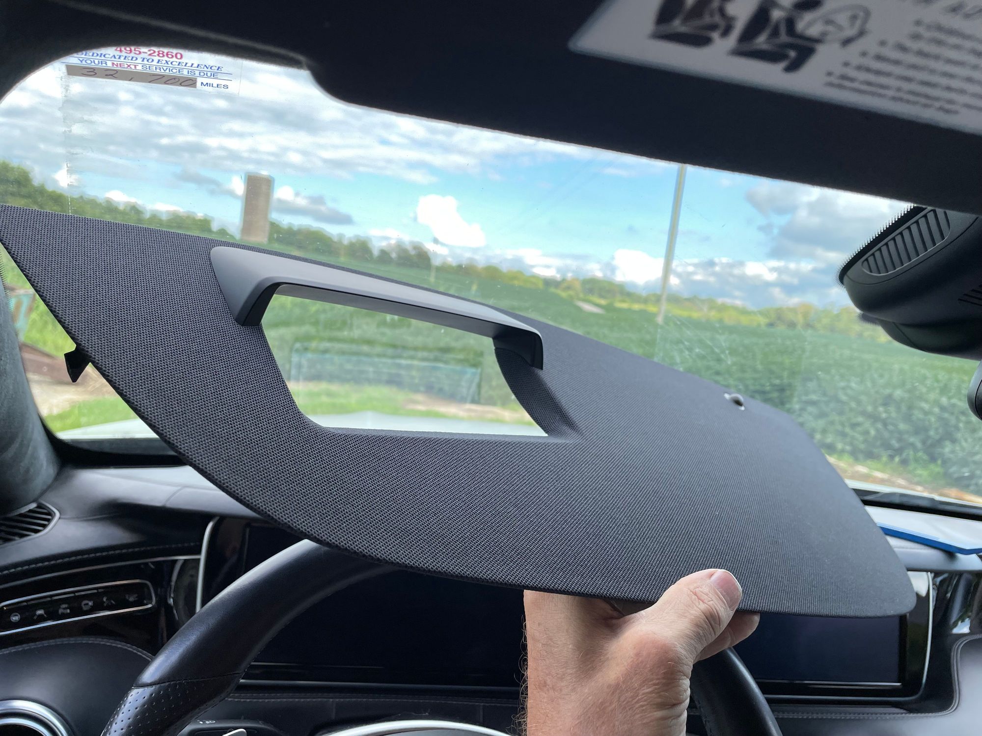

Pry up at the lower right corner and work out towards the drivers door along the lower (closer to you on the dash) edge. Pry up and pull the whole thing towards you to unhook the edge that runs along the windshield. Disconnect the sunlight sensor before trying to clear the trim piece away from the area.
