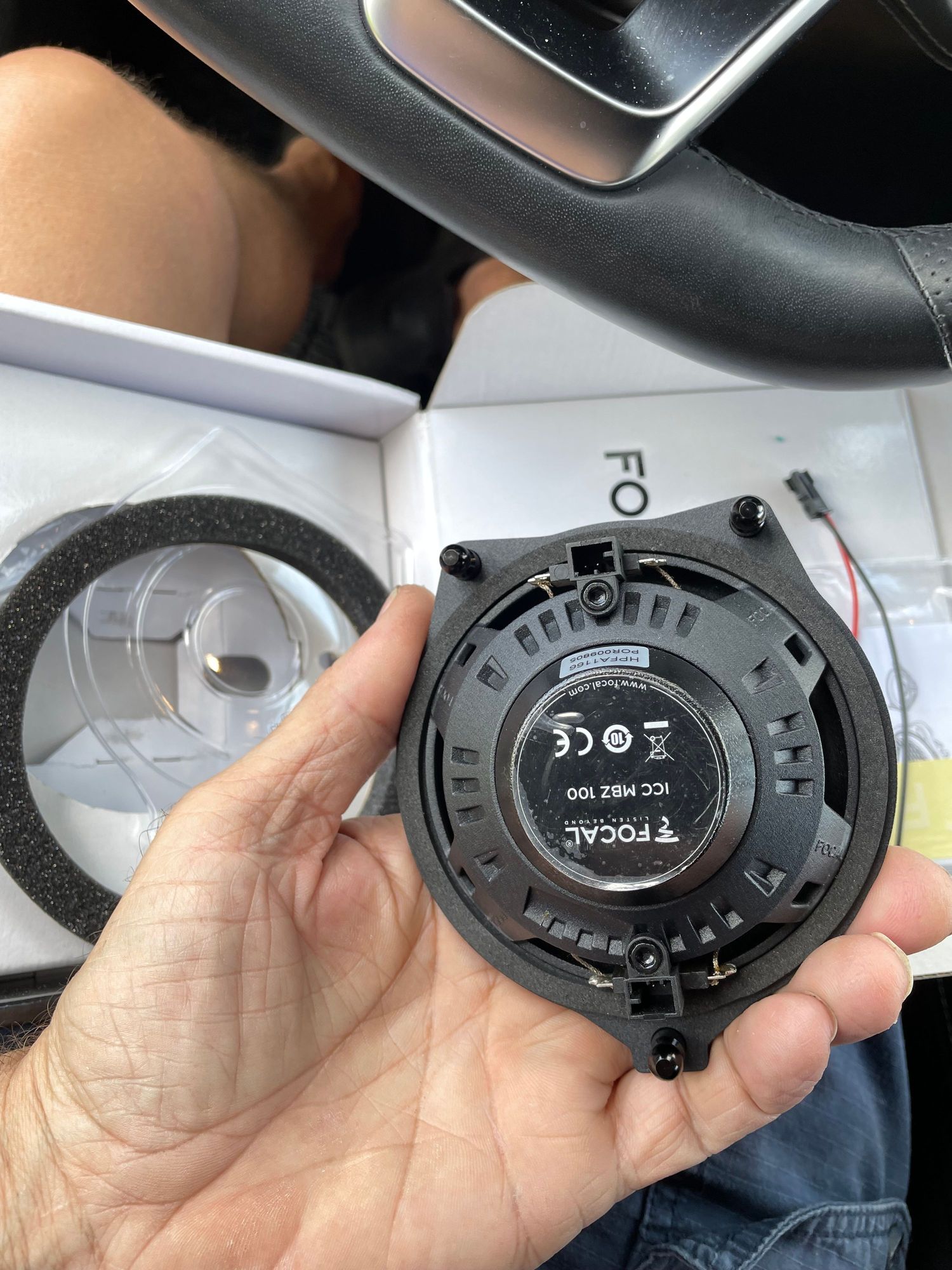

Note that the Focal speaker does not have its three tabs spaced like the oem that came out. So, I used Dynamat to make a bed for the front of the speaker (closest to windshield) and made sure it was fully seated in the single rearward hole. To do - either find the Focal that is spaced like OEM for this location, or drill proper holes into the dash opening to accept the front two Focal tabs.
