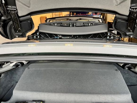

Lower roof into trunk, and use convenience button to lift roof upright. You will see the failed fastener glue, yellowish dots
