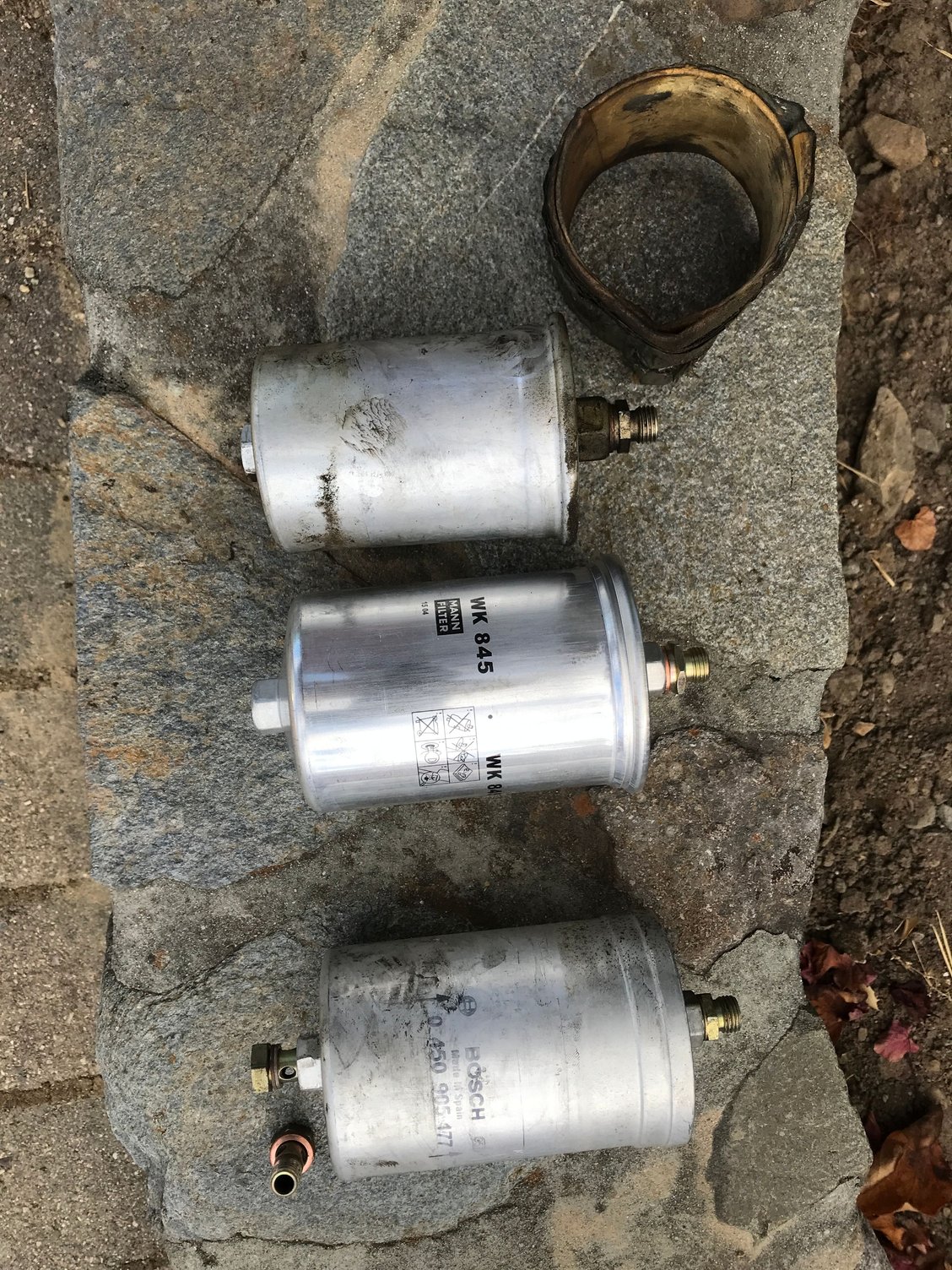

Likewise with tire shops, try and avoid them if you can for things other than tires. Here is a case in point.
My friend took my car (when he had it to a reputable local tire shop for filter change. They put in some no name aftermarket fuel filter that was not even the right size.
They jammed some cardboard so it stays in place. Then proceeded to break one of the small studs that hold the plastic cover and zip tied it instead. This is the level of care that I am expecting from most tire shops unfortunately.
Top is the tire shop special with the cardboard
Middle is the OEM Mann
Bottom is OE Bosch
