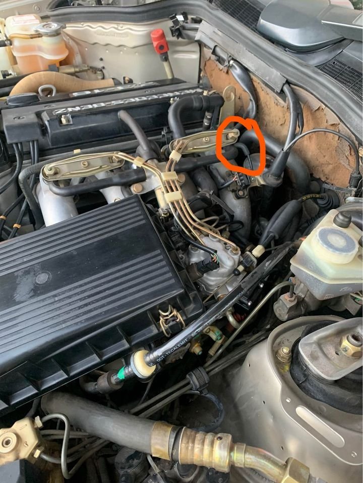

Hi all,
I missing this vacumm line from my engine. I want to know where it's connected to in the engine.
Right now I just plug it up to stop vacuum leak.
Thanks.

Don't know much about 16V cars. Two questions/comments
(1) Do 16V come in auto transmission? If so that is the regulator for the auto.
(2) If you have a manual transmission that should be plugged as it has no regulator and no other use as far as I know. My 12V manual transmission has the same post plugged from the factory.
Take this with a grain of salt, I have only seen the 16V in car shows, never had the pleasure to own one.

I think tou have answered my question. I have a manual transmission..
thanks very much!
