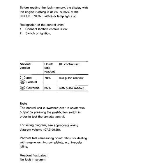

So I replaced the fuel pump relay and did the fuel pump and fuel filter as well as week later. Those are 32 years old and I believe its time to replace them even though they are still functional. I just don't want to have issues with the fuel pump later on. No more no start and no more CEL.
I do have one question -- I wanted to check the duty cycle on my car. Since this is a CA car, do I need to press the button for 2 to 4 seconds on the X92 port before I can measure the duty cycle on X11 port (#2 and #3)? I am having trouble getting readings on those pins. Can you share any info on how to do it on CA cars?
Thanks,
Peter

I figured this out. You need to press the button for 2 to 4 seconds… after 1 blink of the LED, assuming there is no fault codes, you need to press it again for 2 to 4 seconds. After this I was able to read the duty cycle from the x11 port. I was at 80% so I adjusted it to the correct % — 50%.

Great! Yes, sometimes it takes 2 tries for me too. Since it was off and you re-adjusted it, I assume you also checked the duty cycle at 2500rpm. and made sure it does not move more than 10% on average compare to idle duty cycle (positive or negative).

If you have a CA car you should be at about 85% not 50%

that is with ignition switch on, which I am getting. If 85% on ignition on, it indicates a CA car. If 70% with ignition on, that would be a federal car.
