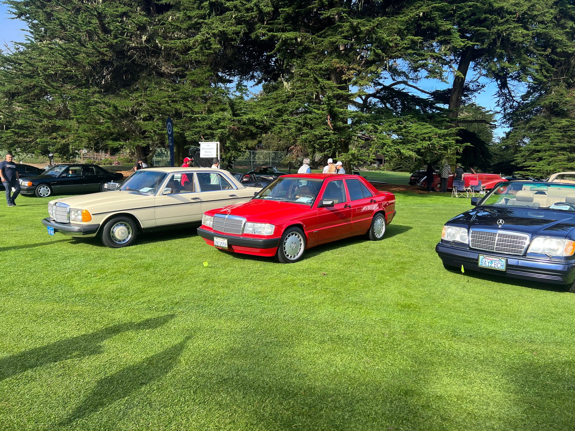

OK, I needs some options, First my 190 is standard looking but I want to get it mostly original. I will be putting new shock and springs all around. I do not want to do any fender roll maybe spacer ( if I know more about the process) Would I better just staying with 15 inch rim but going up to 6 1/5 or 7 like the EVO (price a factor) or going to16 inch rim. Would like the car to maintain the stock look but little beefier. Am I dreaming. I willing to go up to 500 maybe higher to get the right look. Thanks
Old Oct 23, 2024 | 10:05 PM
dolucasi's Avatar
Joined: Mar 2016
Posts: 1,361
Likes: 194
From: SF Bay Area, CA
190E 2.6L 1989, 190E 2.6L 1988, BMW 535dXdrive 2014, BMW 428i 2015
It is all possible but it costs quite a bit of funds to get there.
Actually I did pretty much what you are wanting to do:
(1) Swapping stock springs with MB sportline springs (<$200 if used, ~$600 if bought new from MB, they still had a good stock in Germany 5 years ago)
(2) Swapping front anti roll bar from stock to Sportline (New MB was about ~$200)
(3) Replace only front shocks with Bilstein H8 sport (~$350). Leave the rears alone unless you want to also replace rear roll bar which is difficult. This balances the roll because believe it or not the rear sportline roll bar is actually softer than a standard roll bar. So if you leave the regular shocks in that is almost the same as replacing both. You can save $300 by not changing anything in the rear suspension. This is what I have and I actually have a brand new MB roll bar in my attic. I never bothered to install it and also replace the shocks as mine were new MB standard Sachs.
(4) Rims, for the original look go for the 16 inch R129 rims with 205/50R16 tires. Continentals are good. - This will set you back $1000 with new tires.
(5) When done, if you have $50 to spare, you can put a sportline sticker on the moldings.
(6) When replacing springs you may need to swap the rubber pads for the springs. You need can drop the suspension as much as 1/2 inch.
So you need ~$2000 in the long run if you DIY all of this, a whole lot more if you have others do the work.
This is the look you get with these swaps. I'm also happy with the vast improvement in the ride. It was worth the effort and I used all MB parts except sportline shocks which were NLA.
