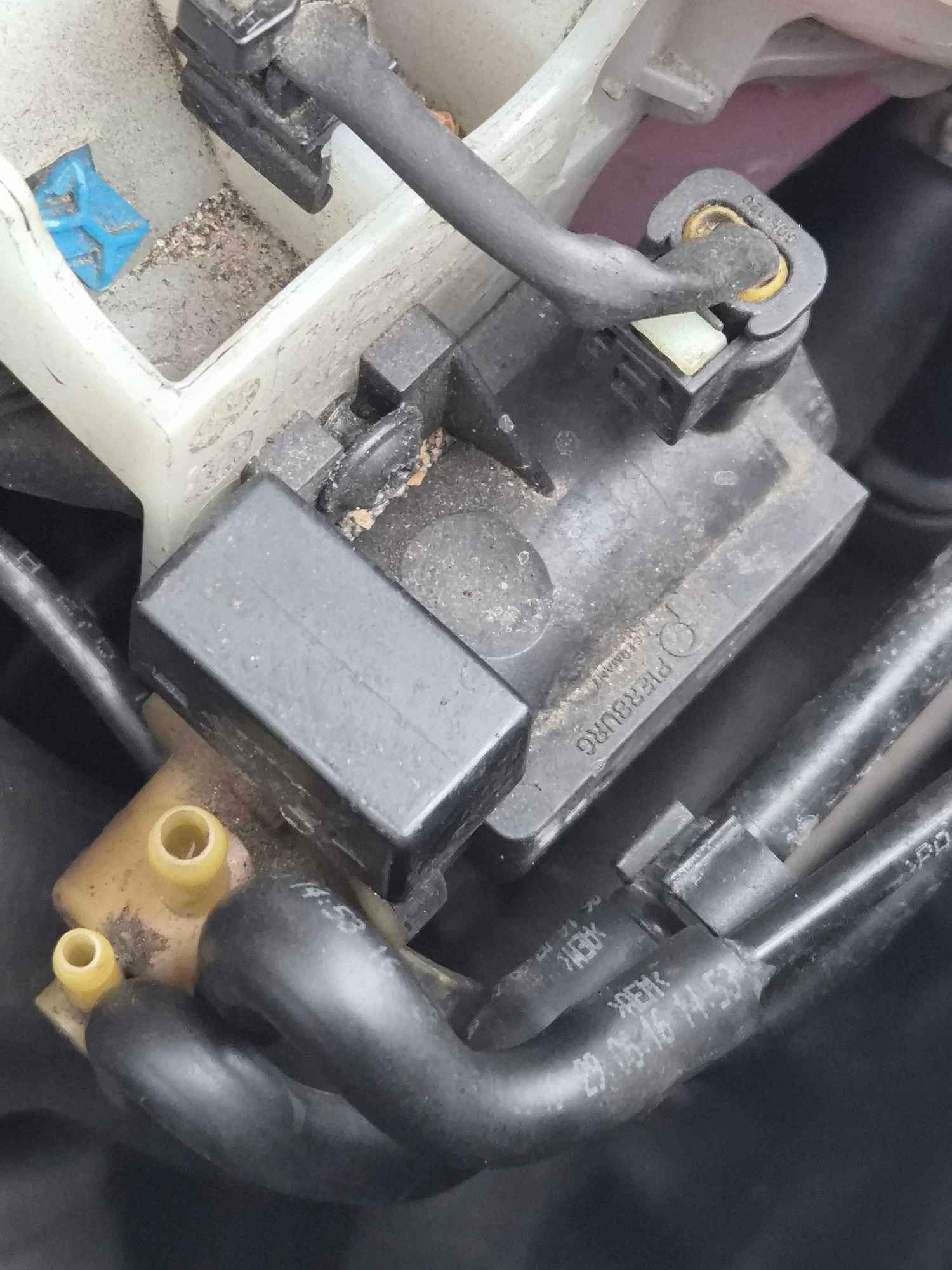

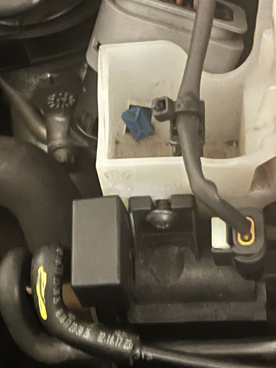

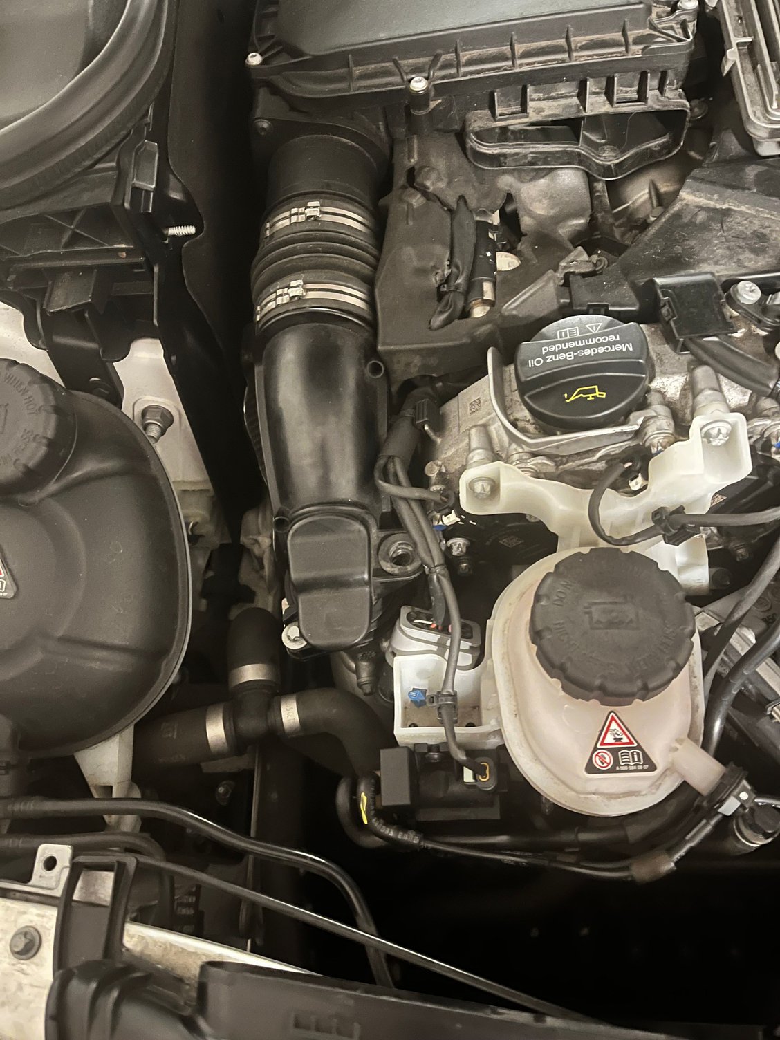

E400 Cabriolet
Originally Posted by Morflavo
……The only other thing I can think of is the boost control valve being bad. In which case, where is it on the engine? How hard is it to get to?
The waste gate controller is easy to change.
I removed mine to inspect the built in filter (getting to the filter is a bit tricky)
NOTE: The vacuum leaves the controller and it is split into two with a Y pipe so unless one of the pipes is broken after the Y then it is unlikely that you have a waste gate vacuum problem
The valve is to the left of the reservoir for the inter cooler
Close up of the valve. I painted one of the vacuum lines so that I didn’t get them confused when I reassembled
I suspect that you have a different problem

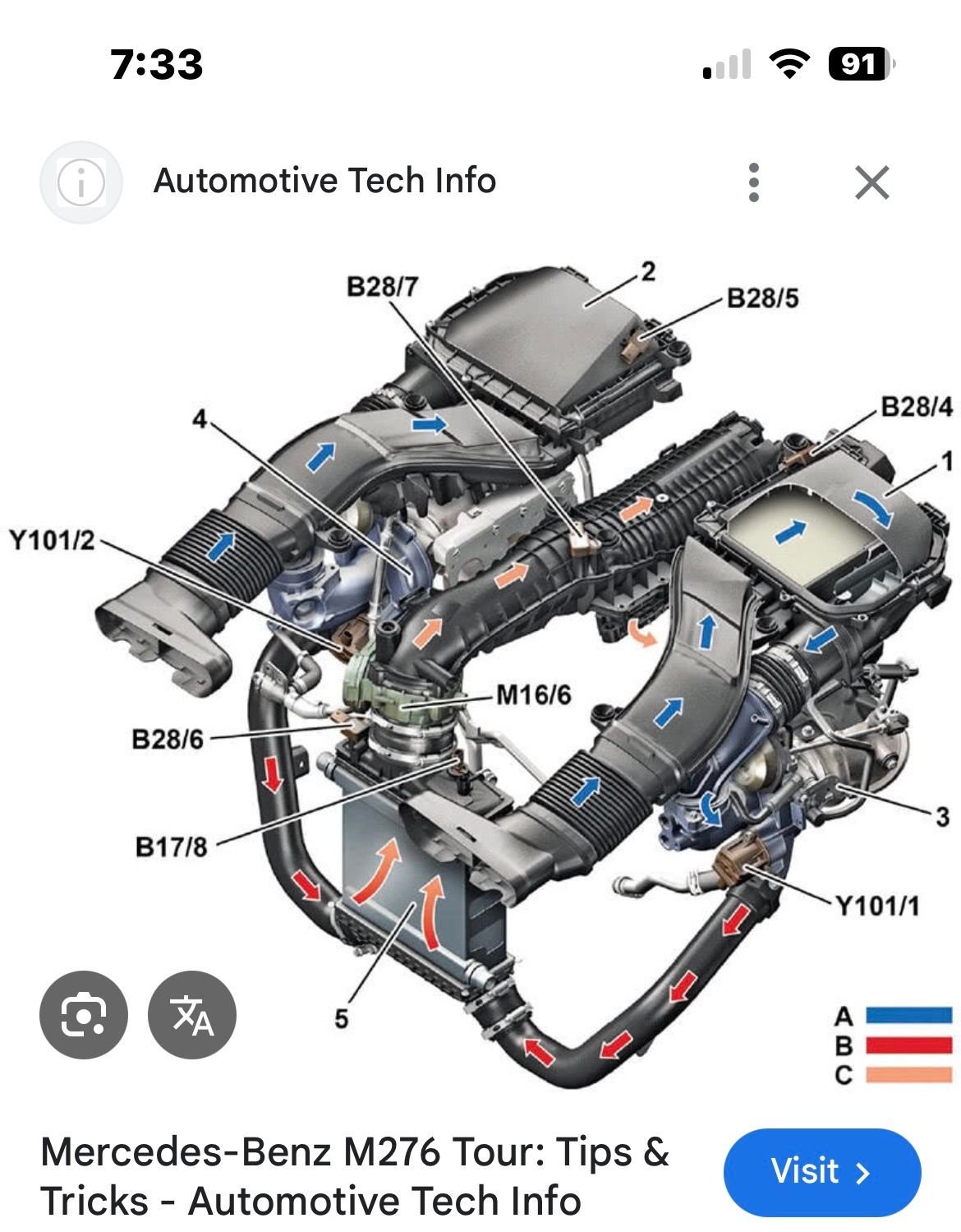

But there is another possibility.
The turbo charger is an exhaust driven turbine and a compressor for the intake air.
Up to now you have been focusing on the vacuum for the waste gate on the exhaust side.
But you should consider that the intake side has a diverter valve that will cut out boost by diverting the air back into the turbo instead of into the engine.
The diagram that Mercedes is using is no longer used by VW because of reliability problems
I upgraded one of my diverter valves to a DV+ to eliminate this problem (the other side is difficult to get to and I haven’t done it yet)

@p_gill I have done a test on the boost control solenoid and determined it is bad. Air flows out of the small tube if I blow lightly into the large tube in both positions after applying 12V, suggesting a torn diaphragm. I have ordered a new one from FCPeuro.
My wastegate actuators are open all the way at approximately 17" of vacuum.

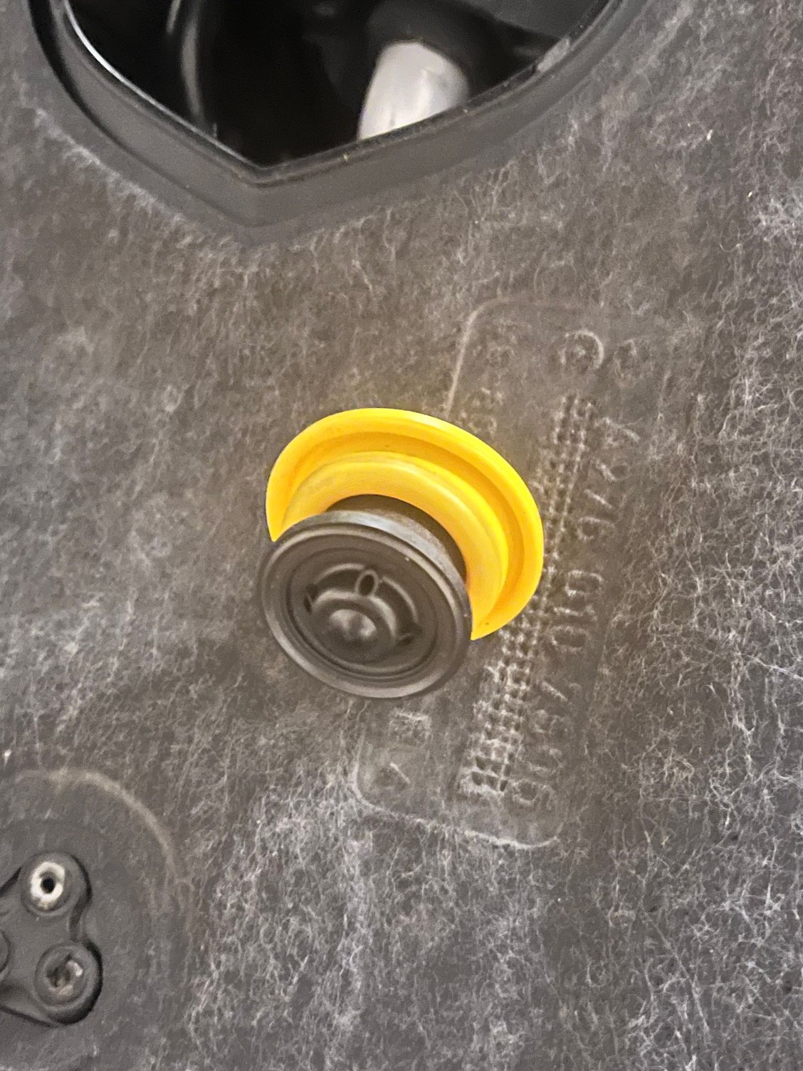

My C43 was Honking like a goose. This is what was replaced. I don't think I had any boost issues just Honk Honk. Only 35k
You mean the pressure transducer? That is a common issue on these engines but at least it is not difficult and not expensive to replace.

The new solenoid did not solve my problem. At this point, everything I have checked seems to be good. I'm worried I need a new pair of turbochargers to get wastegate flaps that line up right...
  • No boost leaks at any charge pipes
  • Wastegate actuators fully actuate and hold vacuum at 17"
  • Vacuum pump check valve replaced, holds 28" of vacuum at idle
  • Boost control solenoid replaced (new one had same behavior as old one, so if someone can outline a better diag for that, maybe the new pierburg part was bad)
  • Wastegates do not actuate in and out at idle
  • No vacuum leaks between check valve and solenoid or solenoid and wastegates
Is there anything else I can diagnose without spending money? At this point I have a diag appointment scheduled for Wednesday at my local dealer in the hopes to find out definitively what's wrong and I pray it's something trivial that I'm missing and not needing a new pair of turbochargers, because that's expensive and will no doubt snowball into a pair of modalworks hybrids
