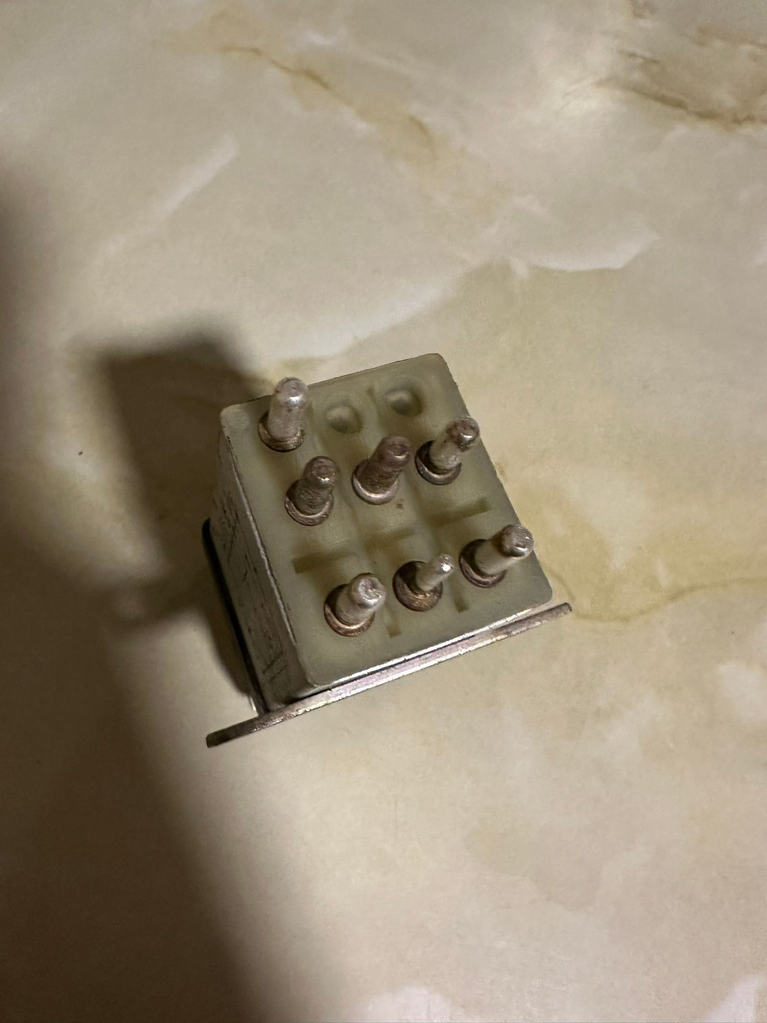

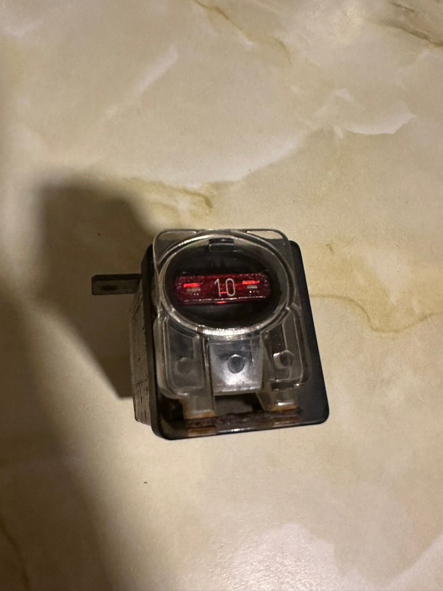

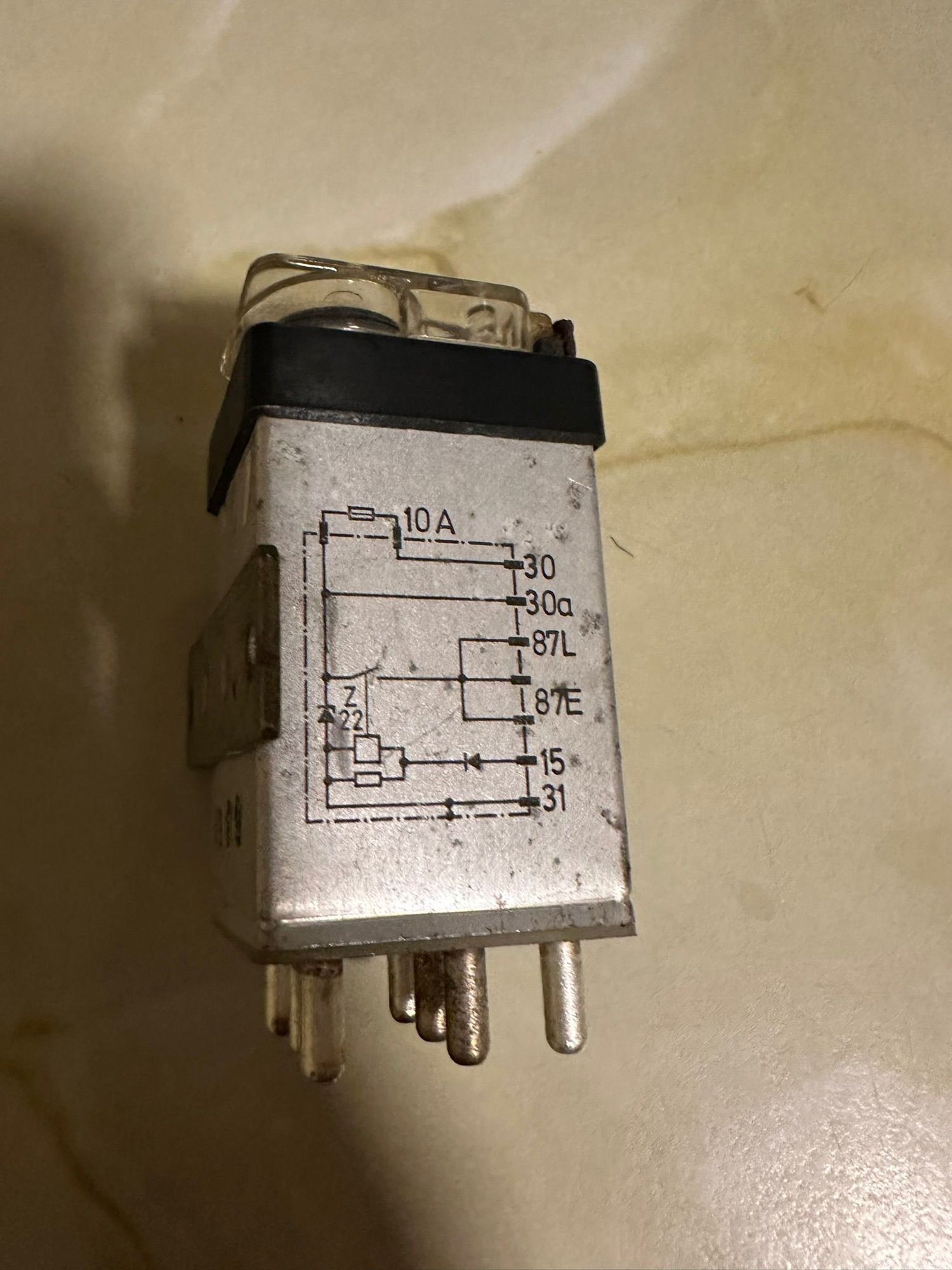

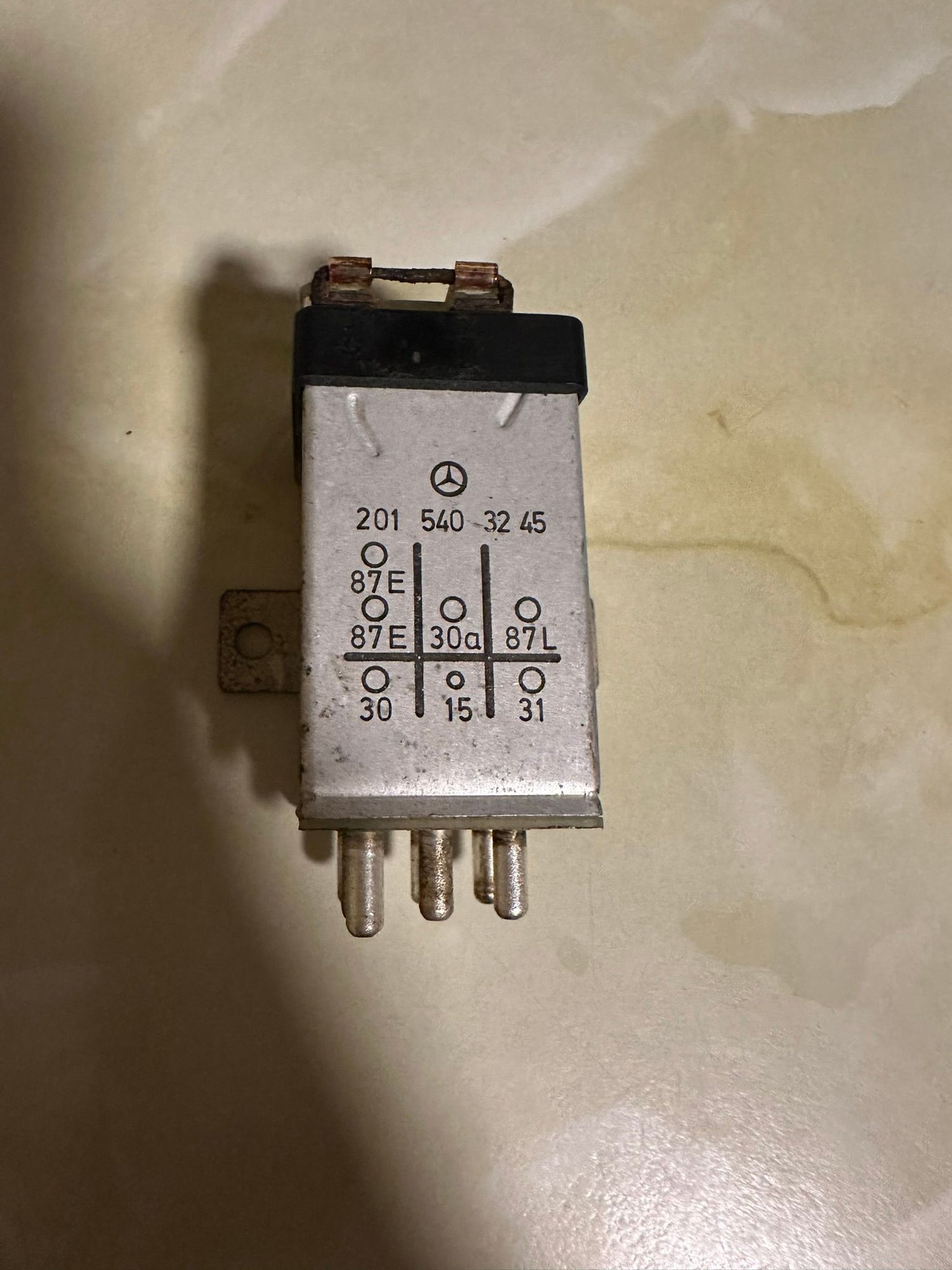

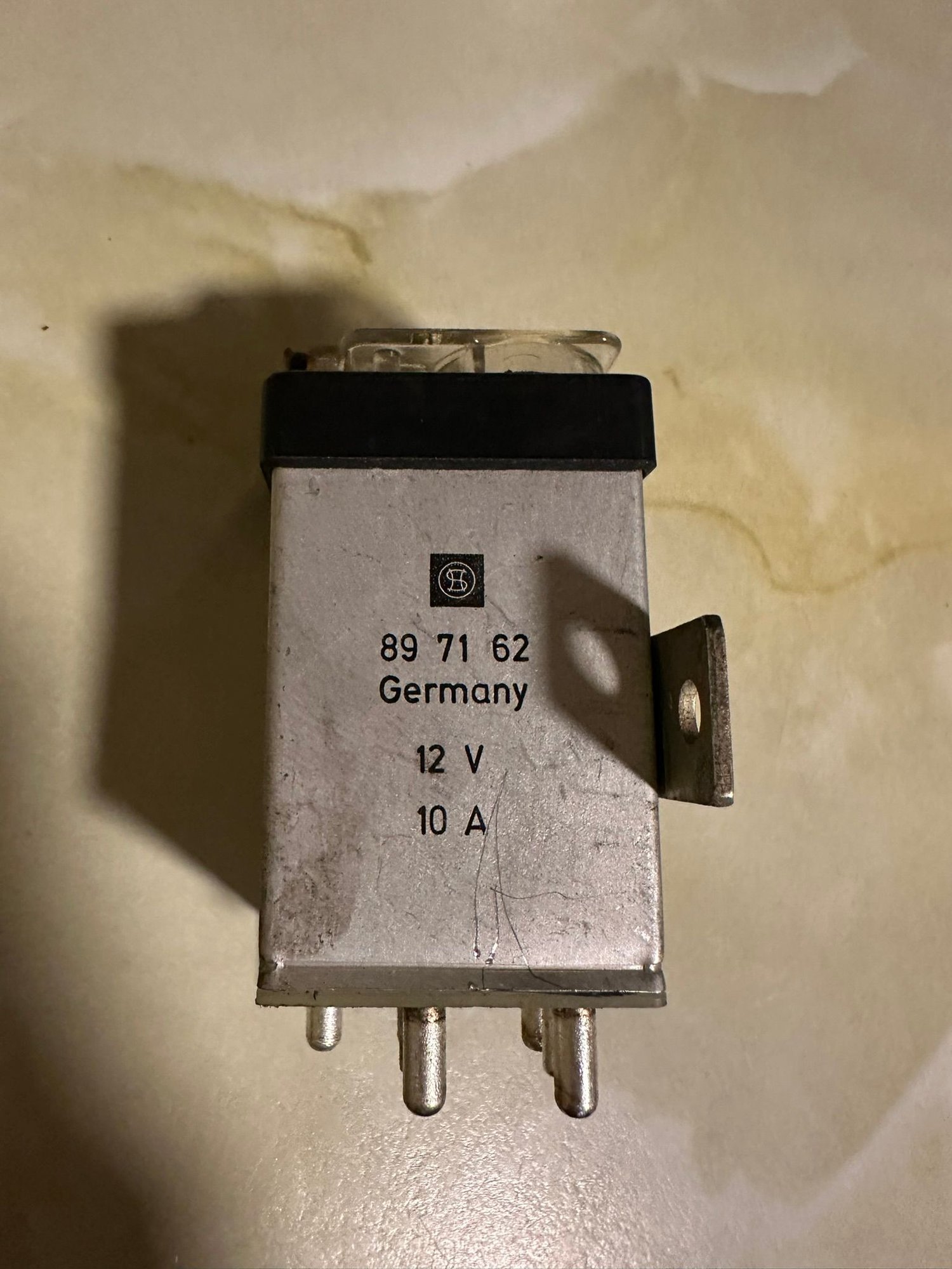

Hi,
Due to a few issues I've determined I should probably eliminate the OVP relay as a potential cause, and the symptoms of the car agrees.
The part number for mine is 201 540 32 45 but all the ones I can find new are 9 pin part 201 540 3745.
I did end up buying a 9 pin thinking there might be blank spaces for the 2 pins that would simply go unused, but it doesn't fit at all. What's the play here, is there a way to get a new replacement at a reasonable price? These 9 pins seem to be priced reasonably, but I can only seem to find expensive second hand relays that match mine, and I don't see the point in replacing it with a part that is just as old as my car.
I have a 1992 2.0 190E.
Appreciate any assistance.
I've attached images, sorry for the size, I don't seem to be able to modify it here.

If all else fails (meaning dealership/classic center etc.) I wonder if you can change your socket to a socket that mates to a 9 pin later version. Meaning some of the pins would be not connected.
You can probably match the circuit drawing on both parts to just connect the common pins. There must be a writeup on this somewhere on the internet.
Will require some soldering. If you attempt such a thing you must disconnect the components (ECU, EZL etc that the OVP is connected to. Otherwise you may damage those components.
