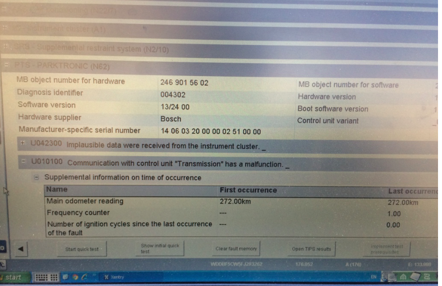

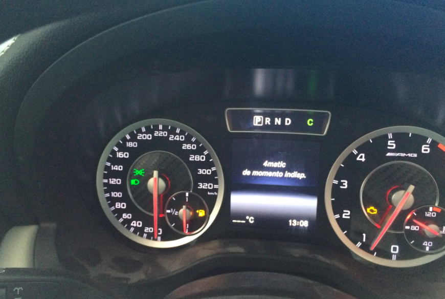

Hi guys, i have one W176 A45 4matic 2014.
Last week the car start move the 1st gear out return to N and appear the message of "4matic unavelable at this moment". So every time that i put the first gear the car move for 10 meters, return the gear to N and again apear the message.

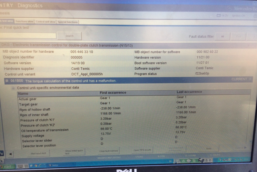

I've requested to an dealer to run the Xentry Diagnostics scan and the following issues appears:
1 - "DKG - Electronic trsmission control for double-plate clutch transmition (N15/13) = 061B00 The torque calculation of the control unit has malfunction "
2 - " PTS - Parktronic (N62) = U010100 Communication with control unit "transmission has malfunction "
Since they doesn't have any experience with A45 AMG cars here in my region they suggested to change my entire gearbox here under warranty , but my car has just 300 miles and i not feeling good to do that.
Is anybody aware of this issue or know how we can procced to fiz this issue?? Or where this modules mentioned above are placed on the car, maybe they can change just them avoid remove all my gearbox.
Any help will be more than welcome.
Best regards,
PS; i've placed the pictures attached to help see what is the failiure.

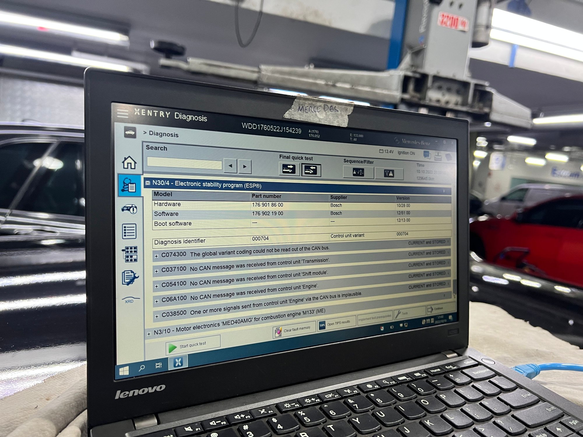

I cant start with 2nd gear, put the M mode, shift to 2, still in gear 1. Already perform full basic setting on TCU and replace the VGS (second hand), still get the same code.
​​​​​​There was other codes that tell communication with control unit transmission has a malfunction. P13C700 also appears. Checked the exhaust valve, works good.
Can ECM causing this problem? I think the car has been tuned, i can hear pop n bang from the exhaust.

Thanks for the fast reply, now looking for loan ECM and check for wiring+grounding. The car is GLA 45 year 2015 with 7k kilometers.
Other codes also appears:
1. AWD: Communication with control unit Transmission has a malfunction
2. ECM: Communication with the electronic selector lever module has a malfunction
3. Electric parking brake: No Can message received from control unit ISM + No Can message was received from control unit transmission
4. Electronic power steering: Communication with the control unit combustion engine has a malfunction
5. ESP: No Can message was received from control unit transmission + No Can message was received from control unit ISM + No Can message was received from control unit Engine + One or more dignals sent from control unit engine via the can bus is implausible
6. DTR: No can message was received from control unit motor electronics + No can message was received from control unit electronic ignition lock + CAN signal shutoff function distronic from control unit ESP is implausible
7. PTS: Communication with control unit Transmission has a malfunction
8. Backup Camera RFK: Communication with control unit Transmission has a malfunction
Thank you

Hi, according to this DTC, I don't think there is a problem with the ECM override. Performance overwriting or chiptuning overwrites Flash memory. If the transcript was bad = DTC completely different and only in the ECM. If someone modifies - overwrites the Eeprom memory, e.g.
EGR Off or Immo Off, etc. = DTC completely differentagain. Your errors correspond to a problem with the system's internal communication. If you are connecting to Star Diag / Das, Xentry / open the ENGINE , open CONTROL and find CAN CHECK or CAN TEST etc. / It differs depending on the version /. And perform the Test. If the check / test is OK, clear the DTC. If the test detects a problem a CAN Dtc will not delete. Run a short test / scan all . Immediately after scanning, clear all DTCs / F9 / then / F5 / - search all again, after scanning F4 and F8 - display only error units - error details. If you don't have a Star diag, try to find it. The control units do not communicate with each other - this is a problem with your A45. The best option is therefore Star diag. Or at least Bosch KTS540 and higher.
Is the battery in the car 100% OK? Fully charged? If possible, disconnect the vehicle from the battery overnight. What diag are you using now?

Hi, already tried the ECM from working CLA 45, problem still the same. I found in ESP live data, the front (both left and right) wheel speed sensor not reading, only read rear wheel speed. Ordering the speed sensor, and we'll see what happen.
Scanned the car using: Launch X431 pro, SD4 and Autel IM 608. I havent try to perform CAN check with SD4, will do this later.
The battery is good
thank you

- car no longer start and PRND doesnt show which gear anymore
according to Xentry
communication with Control Unit 'transmission' has a malfunction
together with
DIRECT SELECT, steering, ESP, AWD ETC
as i was told that my tcu could be damaged, i proceed to order a brand new TCU. I cloned the data from my original tcu to the brand new tcu (using flex) backuo successfully done
Install NEW TCU AND car still cant start with same message
PLUG IN xentry and now shows new fuel pump fault code ( N118, CONTROL UNIT 'fuel pump' FSCU07 ) together with same tcu communication issues - see attachment
what could be wrong? Tcu changed and cloned from original tcu (flashed stage2)
should i somehow get someone to go online for programming or where should i check?
thanks
