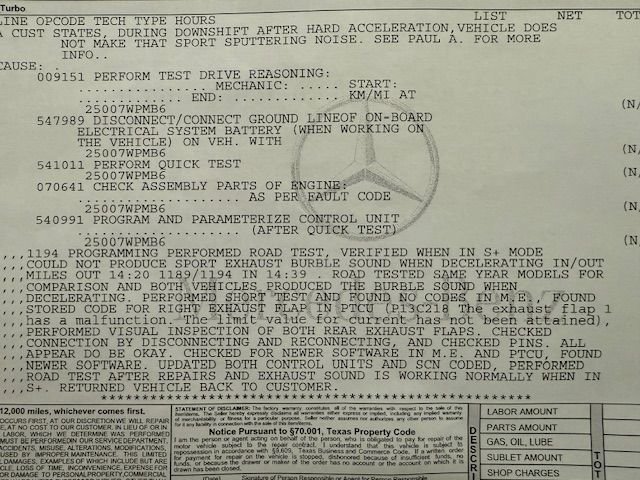

Side note from your other thread: my car still is missing all the burbles and pops like yours did initially. Did you have any more info to share from the technicians? I don’t know if it matters if I take it in now or if I can just wait until after the break-in period.

Awesome! Can't wait to hear your thoughts on the Renntech ECU....that would be the only one I would consider. Are you getting the Renntech warranty with this?
And, my dealer never sent me details on what they did to get the burbles back....I will reach out again....BUT....they can definitely fix this for you....and it's SOOO worth it! This is how the car was engineered by AMG...so it should be making this sound. The service advisor thinks it was some kind of tech reset....but I will find out.
Good luck with your car!!

Jordy...here is the description of what MB did to find my burbles (cracks & pops) on overrun/downshifting)....this should be enough to help your dealer fix for you....good luck!
