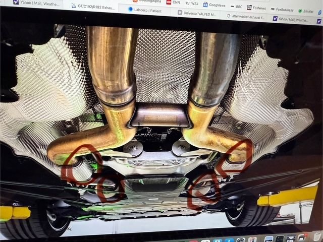

Racked ---
no resonator- just some oem H pipe and huge primary and secondary cat combos (cant pull without a CEL)

Damn! so we can't remove resonators that aren't there (I assume the same for the GT 55 V8).......what are our best options now for more sound? RT exhaust?
Thx for reporting back on this Vic!!

I think thats the only fabricated option --- I think I might straight this fker but the issue is the cel for the valves.
Yes your engine is the same so no res for you too-- sucks

So Vic....I sent your racked pic over to my buddy who has put various exhaust systems/res deletes on his BMW...just asked "what he would do"....he thought maybe cut out these 2 areas (see circle pics below)....not sure what these are...or if this would trigger a CEL...but you seem to know more about this stuff than I do....any thoughts?
Thanks!

Those are just flex pipes, they are thru and thru so it would not help at all.
The front ones are the cats and that will trigger a CEL for sure...
