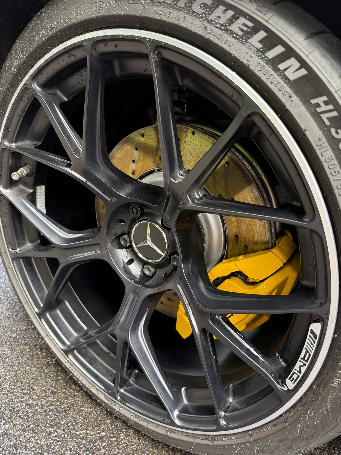

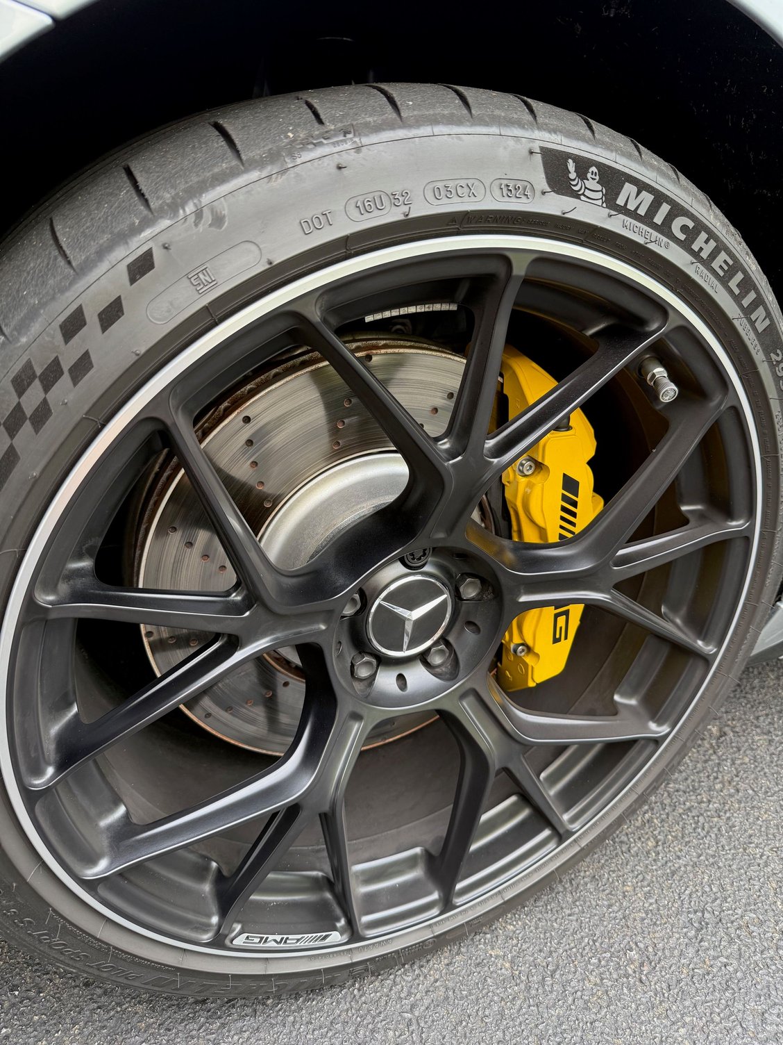

I haven't had much of a chance to drive around but here is the before and after with 89 miles on them. It really is a big difference from the old pads.

All - an update on the brake pads after having tested them on the track at Monticello. DO NOT install the pads if you are planning to track the car. After about three laps of hard braking (think 130mph down to 30 on the straight) the pads started smoking so much that I was black flagged and had to come into the pits to cool them down. They also completely lost braking power when at peak heat. It compromised my entire track day as I had to manage the brakes the whole day by braking well before the braking zone, coasting, etc. I'll be switching back to the OEM pads before heading out again.
I've also noticed that the brake dust does come back with the new pads, it just takes longer. My updated view is that it reduced brake dust by about 50%, less than I originally thought. So bottom line if you are not tracking the car and want to reduce dust, they are option, but for most people probably not enough of a benefit to justify the cost. And they are downright dangerous on the track.
It was worth a shot!
